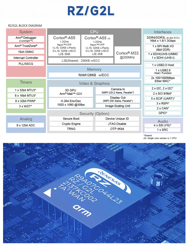

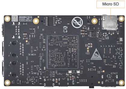

The Remi Pi leverages the RZ/G2L, a dual-core Arm Cortex-A55 processor clocked at 1.2GHz, along with an embedded Cortex-M33 co-processor, 3D graphics, and a video codec engine. It is ideal for applications such as entry-level industrial human-machine interfaces (HMI) and embedded devices with video functionality. The Remi Pi comes equipped with 1GB DDR4, 8GB eMMC, 32KB EEPROM, and a comprehensive set of peripherals including two debug serial ports, two USB 2.0 HOST ports, one USB 2.0 OTG port, two Gigabit Ethernet interfaces, a WiFi/Bluetooth module, one Micro SD card slot, and a 40-pin extension header. Additionally, it supports MIPI-CSI camera interface, HDMI display, LVDS display, and audio input/output capabilities.

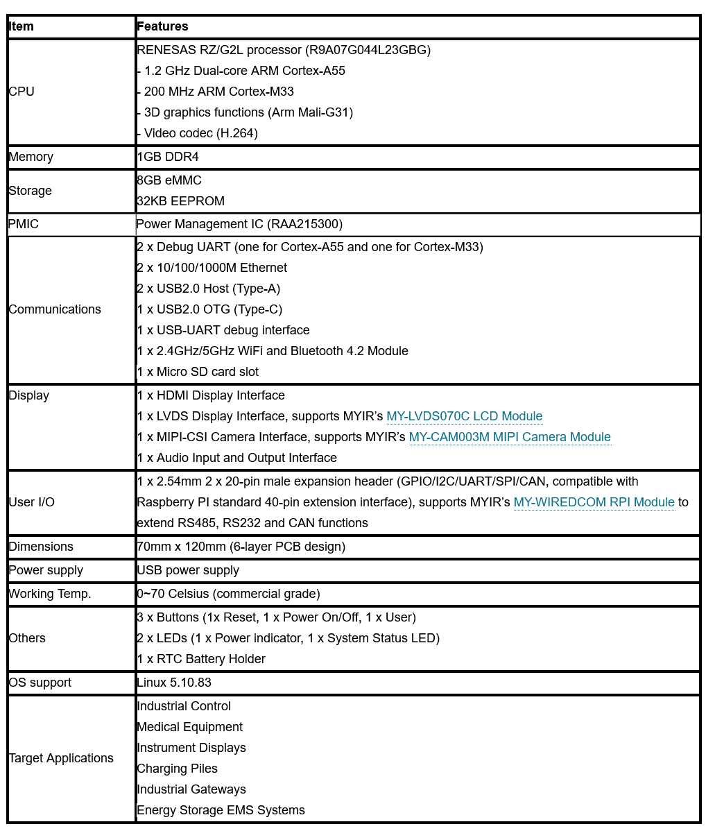

Specifications
