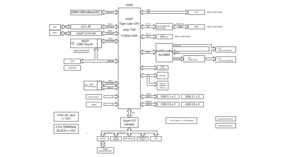

X200 Embedded Computer Board Block Diagram
