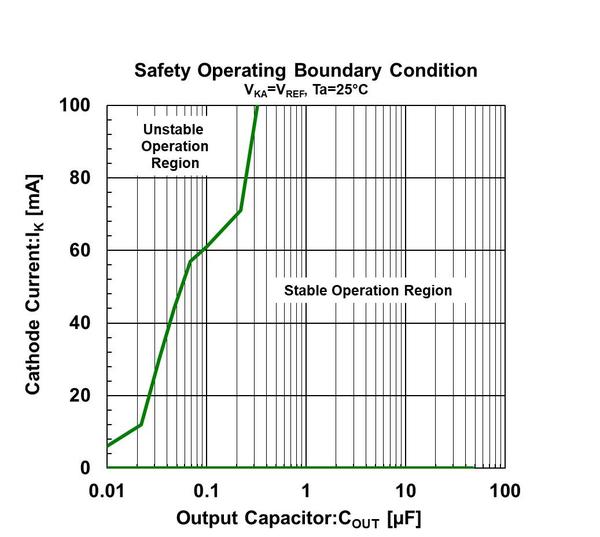

NJR provides samples of a new adjustable shunt regulator NJM17431 with high precision and wide stable operation region that has been designed by latest process and analog circuit technology for many years.
Because the NJM17431 has 0.8% accurate voltage reference and wide stable operation region for large capacitive load, it can be used for a very wide range of applications. And it can replace Zener diode with the NJM17431.
Since the stable operation region is wide, it will help engineers reduce the design man-hours and the burden of replacement evaluation.
The NJM17431 operates stable in the range of 0.01 μF to 100 μF with the actual usage cathode current region.
