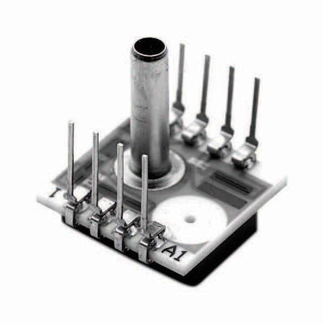

NPC-1210 Series Low/Medium Pressure Sensors
Amphenol’s pressure sensors provide flexibility in low-profile applications where pressure connection orientation is critical
Amphenol NovaSensor’s NPC-1210 series of low/medium pressure sensors provides a cost-effective solution for applications that require calibrated performance over a wide temperature range. Packaged in a dual-in-line configuration, the NPC-1210 series is intended for printed circuit board mounting. Optional pressure port and lead configurations provide flexibility in low-profile applications where pressure connection orientation is critical. The NPC-1210 series is based on NovaSensor’s SenStable® piezoresistive sensing technology. Silicon micromachining techniques are used to ion-implant piezoresistive strain gauges into a Wheatstone bridge configuration. The NPC-1210 series offers the added advantage of temperature performance over the temperature-compensated range of 0°C to +60°C (+32°F to +140°F). A gain-set resistor is included to normalize the FSO for field interchangeability.
  • High sensitivity
  • High accuracy
  • Interchangeable
  • Temperature compensated 0°C to +60°C (+32°F to +140°F)
  • CB-mountable package
  • DIP package
  • Solid-state reliability
  • Individual device traceability
Applications
  • Industrial automation
  • Airflow monitors
  • Process control
  • Medical equipment
  • Underground cable leak detection
  • Ventilation
  • Respirator monitoring
