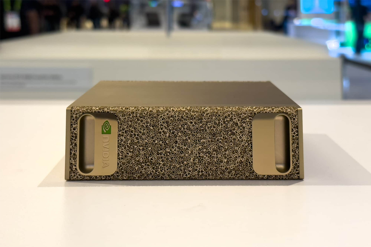

The NVIDIA DGX Spark is a compact, power-efficient AI supercomputer powered by the NVIDIA GB10 Grace Blackwell Superchip, delivering 1000 AI TOPS of performance at FP4 precision. Designed for AI developers, researchers, and data scientists, it enables prototyping, fine-tuning, and inferencing AI models with up to 200 billion parameters locally. It supports AI workloads, data science, edge applications, 128GB of unified system memory, high-speed ConnectX networking, and NVIDIA’s AI software stack.
With Blackwell architecture GPU, 20-core Arm CPU, Tensor and RT cores, 1TB or 4TB NVMe storage, WiFi 7, 4x USB4 ports and 10 GbE connectivity, it offers high efficiency in a desktop-friendly 1.2 kg form factor. It is ideal for developing AI models, validating applications, and deploying edge solutions, seamlessly integrating with data centers and cloud environments.
