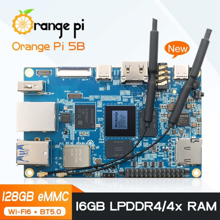

The Rockchip-RK3588S 8-core 64-bit processor, which includes a quad-core A76 + quad-core A55, is in the heart of the Orange Pi 5B. It is built with 8nm design process which makes it faster, consumes less power, brings superior performance to various AI scenarios, and has up to 2.4GHz base frequency. It has an integrated ARM Mali-G610 MP4 GPU, high-performance 3D and 2D image acceleration modules built in, and an AI accelerator NPU with up to 6 Tops of computing power. It has 16GB (LPDDR4/4x) to meet the requirements of products with ample RAM and 128GB eMMC memory, dual-band Wi-Fi6, BT5.0, and can connect up to an 8K display.
An Upgrade of Orange Pi 5
The Orange Pi 5B adds wireless communication Wi-Fi  6 and BT 5.0 to provide a stronger and more stable signal and faster network transmission Wi-Fi supports 2T2R 802.11 ax/ac/a/b/g/n, uses two frequency bands of 2.4GHz and 5GHz, and has MIMO standard. Wi-Fi uses two antennas, one of which is shared with BT and uses a PCIe 2.1 interface; BT5.0 uses the UART/PCM interface 128GB eMMC memory is also added to provide more stable and reliable long-time performance to Orange Pi 5B.

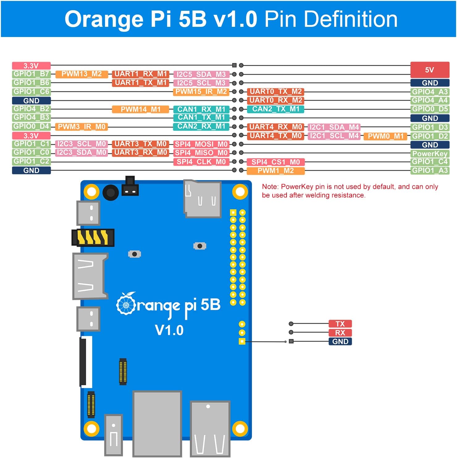

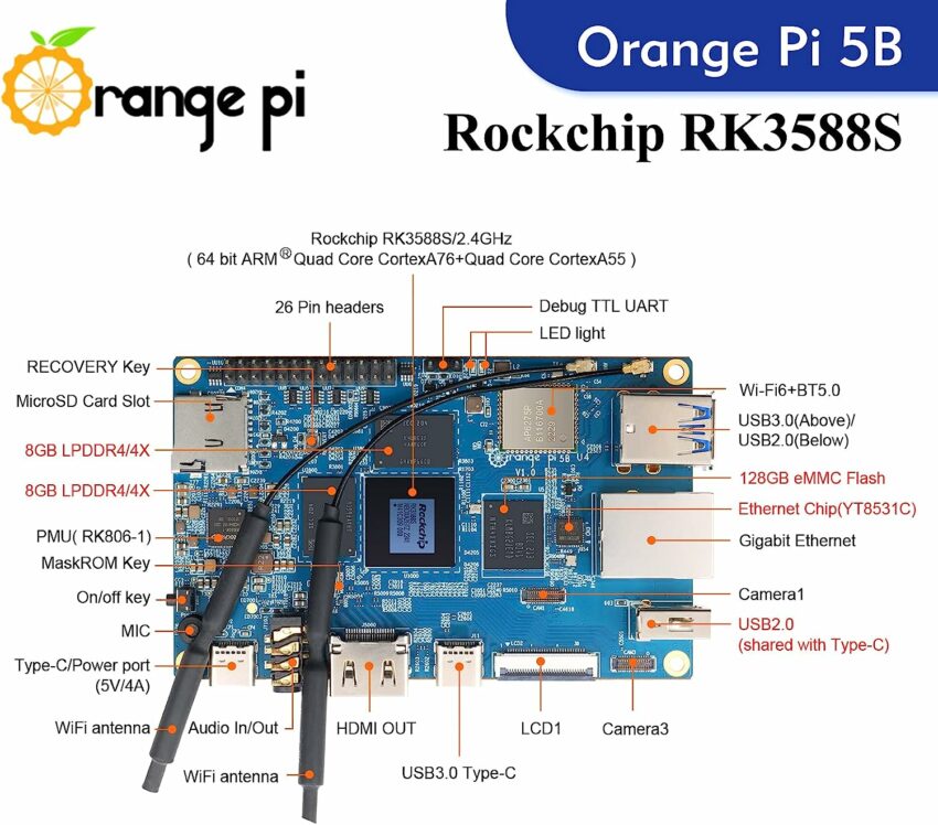

Numerous Interfaces Easy to Expand: Orange Pi 5B Single Board Computer has many interfaces, such as HDMI output, Type-C, USB3.0, USB2.0, RJ45 gigabit network interface, TF card socket, 3.5mm headphone jack, MIPI LCD interface, MIPI Camera interface, multi-functional 26 Pin expansion interface, etc.

  • Processor: Rockchip RK3588S (8nm LP process)
  • CPU: 8-core 64-bit processors, Quad-core A76, Quad-core A55 with 2.4GHz main frequency.
  • GPU: ARM Mali-G610 MP4
  • NPU: Built-in AI accelerator with up to 6 Tops of computing power.
  • RAM: 16GB (LPDDR4/4x)
  • Memory: 128GB eMMC
  • USB: Type-C, USB3.0,USB2.0,TF Card Support
  • Video: 8K@60fps, HDMI 2.1

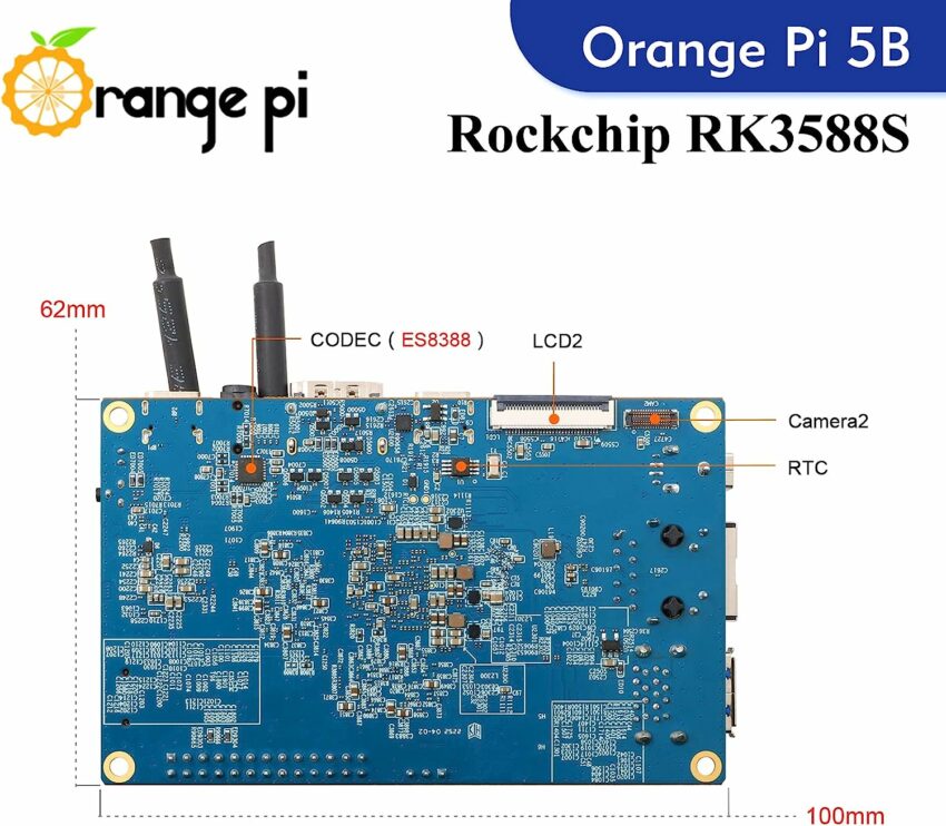

  • Audio: CODEC:ES8388, HDMI 2.1 eARC
  • Camera: MIPI CSI 4Lane, 2 x MIPI D-PHY RX 4 Lane
  • Ethernet: 10/100/1000 Mbps Ethernet
  • Expansion port: For extending UART, PWM, 12C, CAN, and GPIO interfaces.
  • Wi-Fi and Bluetooth: Wi-Fi supports 2T2R 802.11 ax/ac/a/b/g/n, uses 2 x frequency bands of 2.4GHz and 5GHz, and has MIMO standards. PCIe 2.1 interface. BT5.0 uses the UART/PCM interface.
  • Others: 1 x MaskROM key,1 x Recovery key, 1 x On/Off key. LED indicator.

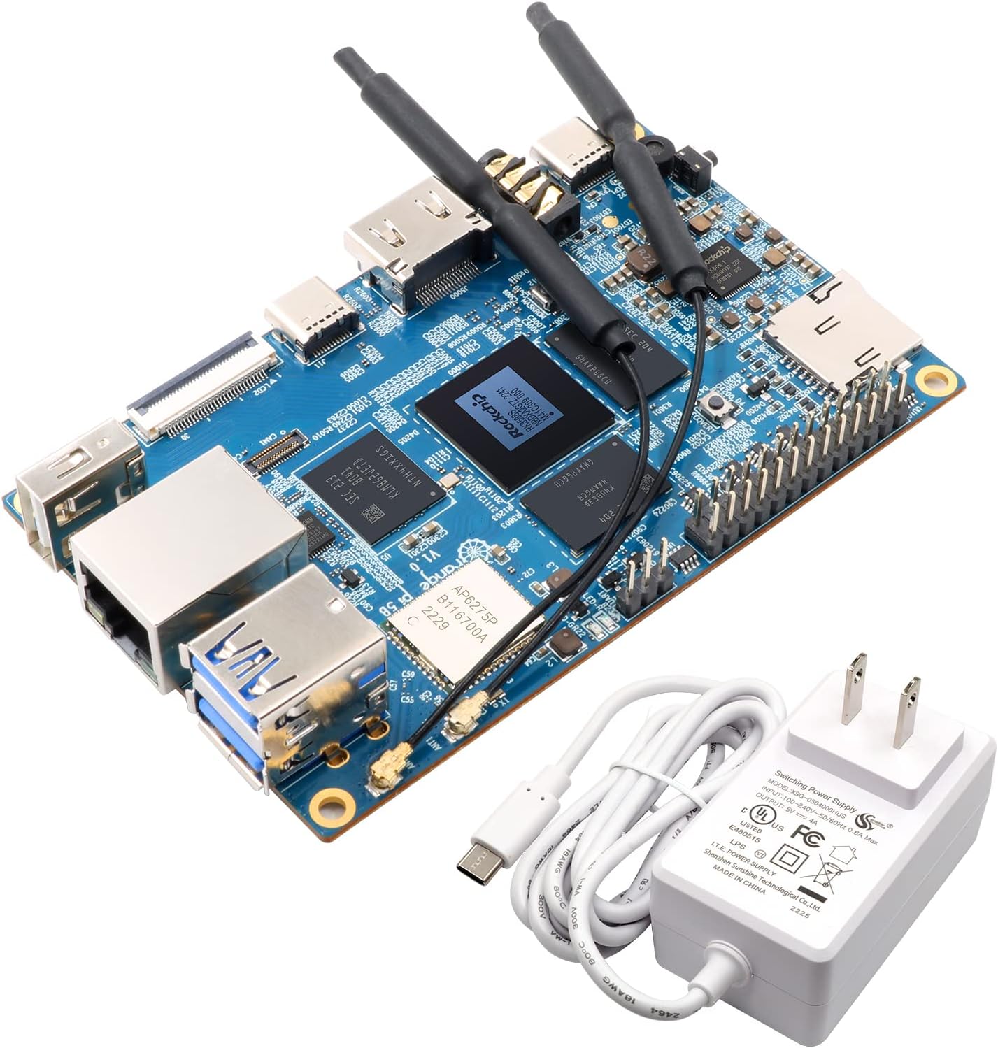

  • Power: Type C power supply 5V @ 4A.

Orange Pi 5B 16GB RAM Single Board Computer can be bought from Aliexpress for 149 USD and also can be bought from Amazon without customs clearance with a fee charged based on the user’s location.
