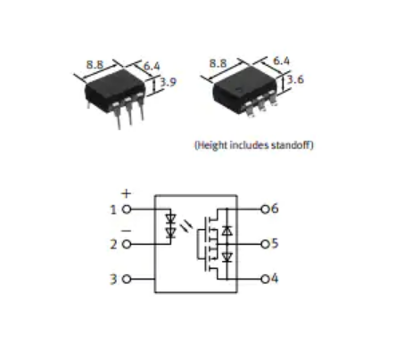

Panasonic Industrial Devices AQV209Gx PhotoMOS Relays are DIP 6-pin type with 1200V load voltage and low on-resistance of typical 1Ω. These PhotoMOS relays operate at 0.75A continuous load current. The AQV209Gx PhotoMOS relays are PCB mount relays with HF 1 Form A high capacity. These relays are capable to switch high voltage loads. The AQV209Gx relays offer a suitable substitution for replacing reed and mercury relays. Additionally, these relays offer high load switching for both industrial and test equipment environments. These relays are suitable for measuring equipment, testing equipment, and industrial equipment.
Specifications
  • 1200V (peak AC) load voltage
  • 1Ω (typical) on resistance
  • 0.75A continuous load current (A connection: Peak AC, DC)
  • DIP 6-pin/1 Form A package/output configuration
