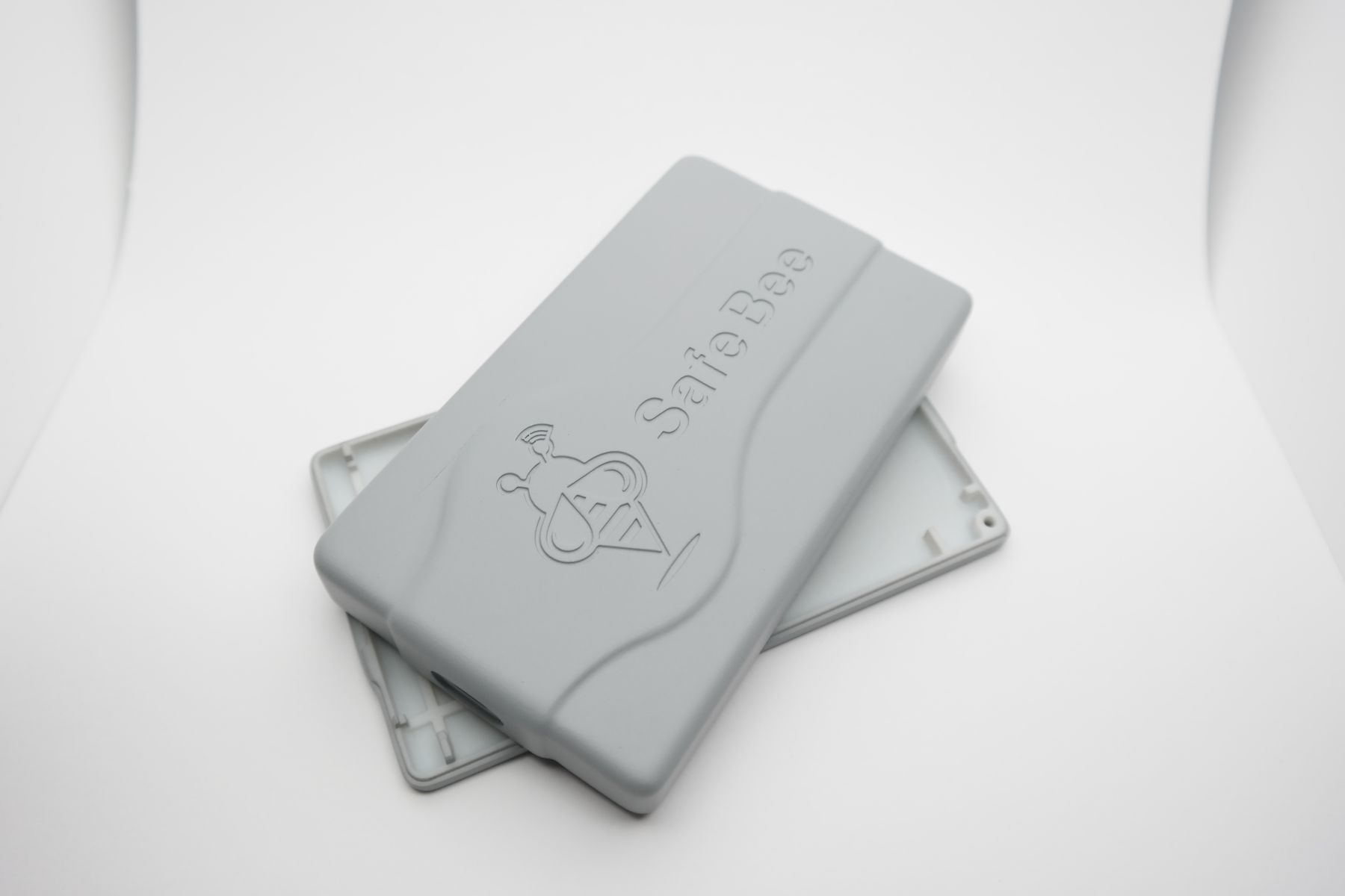

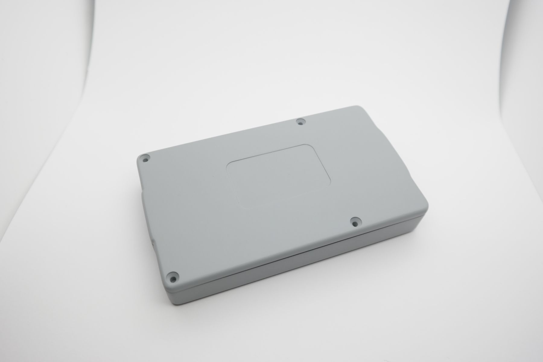

Our enclosure printed on PCBway.com

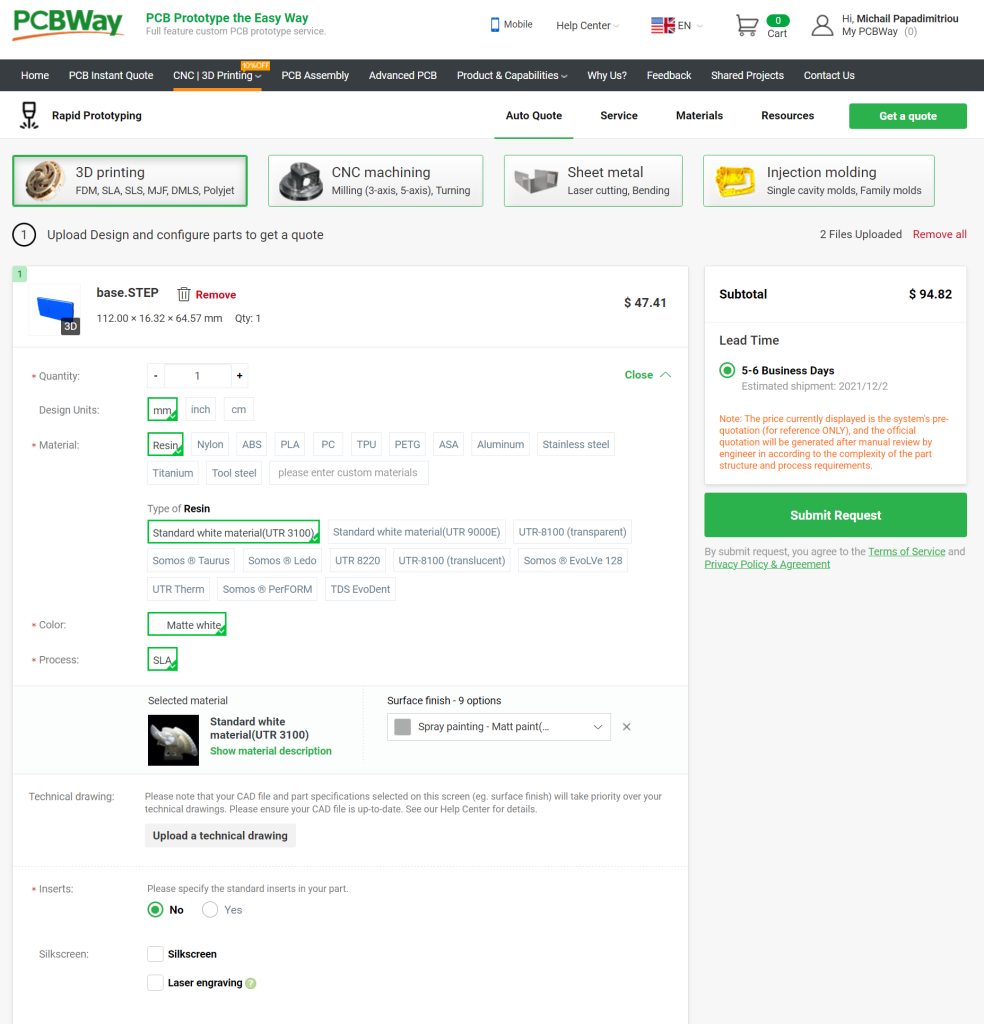

One of the coolest features of the newly launched services for me is the real-time online quotation system. Similar to the process of ordering PCBs, quotes are provided immediately after your CAD file is uploaded and different parameters like color and material, etc., are selected. In most situations, the price varies based on the type of material and color, but you wouldn’t have to wait or engage in back and forth emails to see what the material you have decided to use will cost you. This helps with decision-making and speeding up project timelines in hierarchical organizations as you can quickly inform the decision-makers about changes in price.

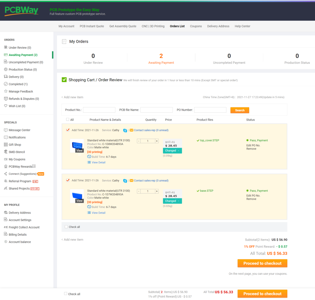

To test their service we uploaded our SafeBee – A GPS Tracker for Beehives enclosure to the quotation system. The system provided a quote of 56.33 USD without shipping to our lab. This cost may sound ok for a prototype but not good for a production cycle. The material we choose was Standard Resin Printing in white material with grey paint finishing. You can see the end product in the photos above.
In addition to providing an instant guaranteed quotation, the online ordering system also provides instant DFM feedback which spotlights errors in your design that may prevent you from getting the desired outcome. This reduces the need for multiple iterations on your part, thereby reducing cost, and ensuring you stay on track with timelines.

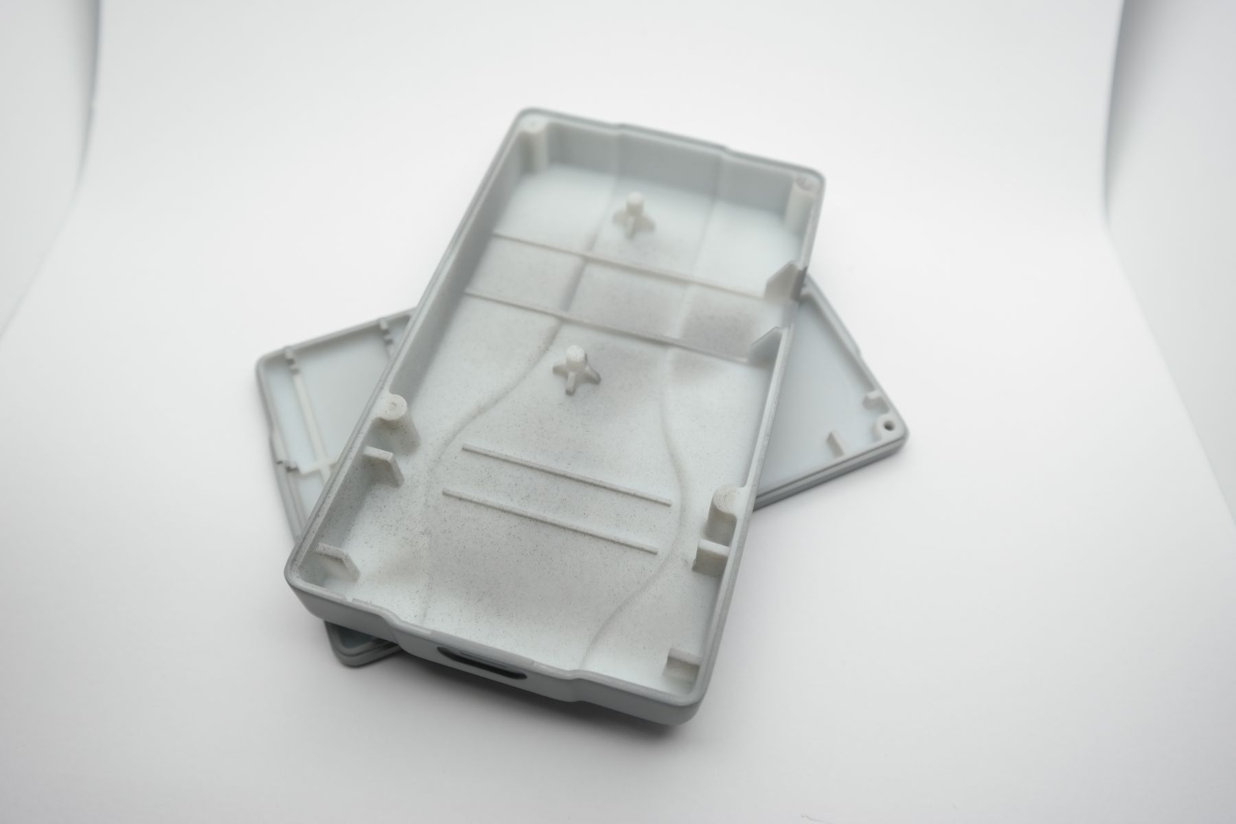

The internal of the 3D Printed enclosure

The delivered enclosure was high quality with a smooth surface finish and our overall experience was positive. The only point we could mention is the high cost of this service that goes up to ~100 USD including shipping with DHL.
