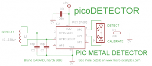

PicoDetector : a simple metal detector
Bruno Gavand build a simple metal detector using PIC12F683. He writes: The idea of this circuit is to hack PIC oscillator circuit, by replacing the crystal by a coil : the frequency of the oscillator then depends on presence of metal near the coil, just like in a classic metal detector. PicoD... Read More
