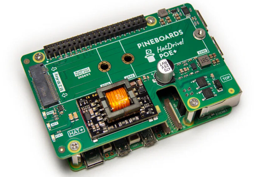

Pineboards has recently introduced the HatDrive! PoE+ versatile Power over Ethernet (PoE) HAT, designed for the Raspberry Pi 5, combines power delivery, networking, and high-speed storage in a single accessory. It supports PoE+ with up to 25W, providing the full 5V 5A required by the Raspberry Pi 5 without additional configuration, ensuring adequate power for connected USB devices. It also features an M.2 M-Key connector, enabling compatibility with NVMe SSDs in 2230, 2242, and 2280 form factors for fast boot storage. Manufactured with premium UK-sourced components, the HatDrive! PoE+ has undergone rigorous testing to ensure reliability and efficiency under maximum loads.
This PoE+ HAT combines power and network connectivity through a single RJ45 cable, simplifying setups by reducing the need for extra power cables. Convenient access to the Raspberry Pi’s camera and display connectors is provided by the design, making it well-suited for setups in remote locations. Use cases such as home labs, IoT projects, or networked Raspberry Pi applications, demand reliable power and connectivity solutions, seamlessly combining PoE and high-speed NVMe storage.

HatDrive! PoE+ HAT for Raspberry Pi 5 Specifications:
  • Compatibility: Designed for Raspberry Pi 5
  • Camera/Display Access: Includes a cut-out for easy access to CSI/DSI connectors
  • Storage Interface: M.2 M-Key PCIe x1 slot supporting NVMe SSDs (2230, 2242, and 2280 form factors)
  • Connectivity: Combines power and networking over a single RJ45 cable
  • Build Quality: Premium PoE module manufactured in the UK
  • Thermal Performance: Tested under heavy workloads for reliable operation
  • Misc:
    • Camera connector
    • Display connector
    • 40-pin GPIO header extension
  • Power Delivery: Full PoE+ support (up to 25W, 5V 5A)
  • Design: Top-mounted HAT with a compact form factor
  • Dimensions: TBD
Additionally, a cut-out is featured by the HAT that allows easy access to the camera and display connectors, making it convenient for setups that utilize these connections while keeping cables neat. No drivers are needed for NVMe SSDs on the Raspberry Pi 5. However, it is recommended to update the firmware regularly to ensure compatibility improvements and optimal performance. More importantly, make sure the GPIO header extension is properly installed on the Raspberry Pi 5’s GPIO headers. Incorrect installation may result in poor contact, preventing the Pi from powering on.
The package consists of a 25mm PCIe FPC cable with controlled impedance, four metal standoffs, an M.2 drive standoff, a PoE header extension, a 40-pin GPIO header extension, and ten M2.5 screws to ensure secure assembly and reliable connectivity. You can check their documentation page for details information.
The HatDrive! PoE+ for Raspberry Pi 5 is priced at €44.00 ($46.15) and can be purchased directly from the Pineboards website. It is also available through distributors like ThePiHut at £36.58 ($38.36) excl. tax. For more information, you can check the official announcement.
