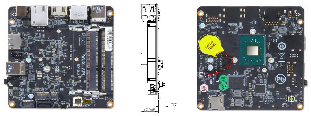

PortWell, the makers, and innovator of several industrial embedded computing solutions who just released the recent Pico ITX Apollo Lake SoC board have just released the Portwell “WUX-3455” board, a small form factor embedded system board featuring the Intel Celeron Processor J3455, known as Apollo Lakes and also part of their WUX-3350 mini PC board series.

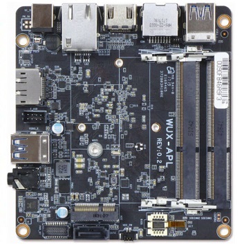

Portwell’s WUX-3455 is a 4×4-inch (101.6mm x 101.6mm) Embedded NUC form factor board, based on the Intel Celeron J3455 Processor plus DDR3l SO-DIMM supporting up to 8GB 1866/1600 MT/s, up to 6x USB ports 3.0 and 2.0, up to 64GB eMMC 5.0 flash storage, onboard microSD 3.0 Socket, one COM port using the RJ45 connector for RS-232, one DisplayPort (DP) and one HDMI with resolution supporting 4K videos.
With a display port and one HDMI port offering a resolution of about 4096 x 2160 and an onboard Realtek ALC255 driven audio I/O, the Portwell WUX-3455 board isn’t shy away from producing 4K videos with surrounding audio, and enough multiple storage interfaces to hold content. The board is equipped further with Gigabit Ethernet, RS-232 ports and enough USB Ports, data communication is made easy. It provides an M.2 slot support, for various wireless options, and a TPM chip is optional.
The Portwell WUX-3455 delivers robust performance, yet it operates with thermal design power (TDP) under 6W/10W for fanless applications. Going with the quad-core Celeron J3455 gives 10W TDP at about 1.5GHz to 2.3GHz, the quad-core Pentium N4200 generates 6W TDP at about 1.1GHz to 2.5GHz, and the dual-core Celeron N35550 generates 6W TDP at about 1.1GHz to 2.5GHz. It also supports a wide voltage of power input from 12V to 19V and a 0 to a 60oC temperature range for rugged applications.

  • Processor –
    • Intel® Pentium® N4200, 4 cores, 1.1GHz/2.5GHz, 6W TDP
    • Intel® Celeron® N3350, 2 cores, 1.1GHz/2.4GHz, 6W TDP
    • Intel® Celeron® J3455, 4 cores, 1.5GHz/2.3GHz, 10W TDP
  • Memory –  up to 8GB DDR3L-1866/1600/1333MHz via 2x SODIMMs
  • Storage Options –
    • 1x SATA III
    • 1x MicroSD 3.0
    • Up to 64GB onboard eMMC 5.0
  • Display & Audio:
    • HDMI 1.4a port at up to 3840 x 2160
    • DisplayPort at up to 4096 x 2160
    • Intel HD Audio and Realtek ALC255 HDA codec
    • Audio jack with line-out or mic-in
  • Networking — 1x GbE port (Realtek RTL8111H)
  • Others:
    • 4x USB 3.0 ports on the rear I/O
    • 2x USB 2.0 ports onboard with pitch 2.0 header
    • RS232 port
  • Expansion — M.2 E+A key for WiFi, Bluetooth, 3G, 4G
  • Other features — Watchdog; hardware monitoring; optional TPM 2.0
  • Power — 12-19VDC input jack
  • Operating temperature — 0 to 60°C
  • Dimensions — 101.6 x 101.6mm (4×4-inch eNUC form factor)
