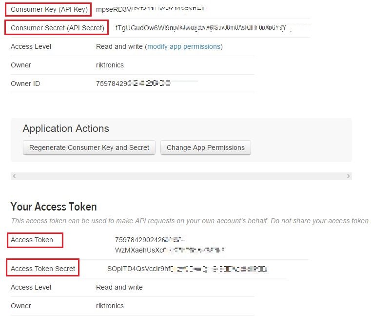

Create App In Twitter
You need to create an app in Twitter so that Raspberry Pi can use to make tweets on your behalf. Go here to make a twitter app. The Raspberry Pi will require following parameters to make tweets:
  • Consumer Key (API Key)
  • Consumer Secret (API Secret)
  • Access Token
  • Access Token Secret
You can find all these details from your app.

Get Access Keys And Access Tokens From App
