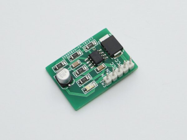

This tiny module is a PWM Solenoids and Valves driver using Texas instrument’s DRV103 low-side DMOS power switch employing a pulse-width modulated (PWM) output.
72 in stock
  in Stock:  72
 Delivery time Ships within 24 hours
SKU: EL51130 Category: Tags: , ,
Description
This tiny module is a PWM Solenoids and Valves driver using Texas instrument’s DRV103 low-side DMOS power switch employing a pulse-width modulated (PWM) output. Its rugged design is optimized for driving electromechanical devices such as valves, solenoids, relays, actuators, motors and positioners. This board is also ideal for driving thermal devices such as heaters, coolers, lamps etc. PWM operation conserves power and reduces heat rise, resulting in higher reliability. In addition, adjustable PWM allows fine control of power delivered to the load. Output delay time and oscillator frequency are also externally adjustable.
The DRV103 can be set to provide a strong initial closure, automatically switching to a “soft” hold mode for power savings. A resistor, analog voltage, or Digital-to-Analog(D/A) converter can control the duty cycle. An output OK flag indicates when thermal shutdown or over current occurs.
