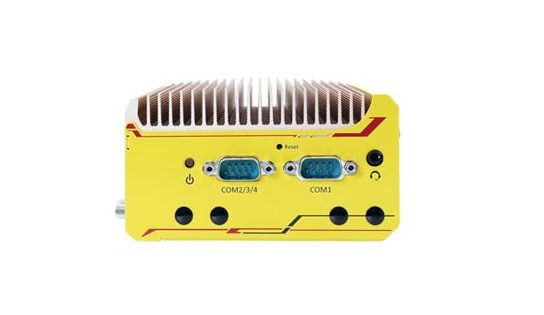

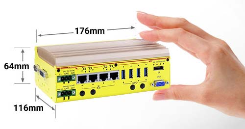

Neousys Technology Launches the POC-551VTC – an AMD RYZEN PC for Transportation
Neousys Technology, the embedded computing platforms manufacturer, has announced plans to launch an ultra-compact, rugged fanless in-vehicle computer called the POC-551VTC. The new computer was designed as an upgrade to the POC-500 embedded computer which the company released a while back and it comes with several I/O ports to serve applications around wireless communication, mobile Surveillance, in-vehicle entertainment, and fleet management to mention a few.
