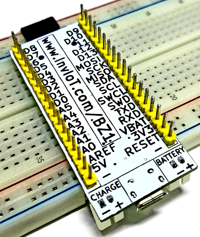

Zero BZ1, (Arduino-Compatible) with SD and LiPo charger
Zero BZ1 Board
Another interesting board I recently came across is the Zero BZ1, which is an Arduino Compatible board that comes with built-in SD card storage option and a LiPo charger, but most importantly it is inexpensive at least as compared to most boards.
The Zero BZ1 is Arduino Zero compatible since it runs on the same processor; the 32KB of SRAM and 256KB of flash memory ARM Cortex M0 microcontroller SAMD21G18. The inbuilt Lithium Polymer (LiPo) battery charger and regulator makes it ideal for battery-powered applications, combined with the SD card you will get a full powered device geared towards data logging application that can run autonomously for a long time.
It comes with a Micro SD slot, Real-time Clock (RTC), 10-bit DAC, Lipo regulator, USB for uploading and debugging, LED for indicator or debugging, an onboard temperature sensor and some decent number of IOs. Any attached LiPo battery can be charger using a USB or a 5v – 6v solar panel.
Below are some of the device specs:
  • Processor – ARM Cortex M0 microcontroller SAMD21G18
  • Memory – 32Kb of SRAM and 256KB of Flash
  • Operating Frequency – 48MHz
  • Others – PWM Supported – 20 PWM pins
    • 12bit A/D converters, 14
    • 10bit D/A converter, 1
    • I2C,  6
    • SPI, 6
    • UART, 6
    • Temperature sensor
    •  SD card Socket
    • AP2112 Voltage regulator 600mA
    • MCP73831 Li-Polymer Charge Management Controller
  • Dimension – 24mm x 54mm (0.94in X  2.14in)
An interesting possibility is combing the Zero BZ1 with anESP32, which will easily make it an ideal edge computing IoT device. The board is currently being crowdfunded on Kickstarter, and it goes for about $18. The Zero BZ1 Kickstarter campaign is running until January 14th. If you are lucky enough, you might be able to get the board for $14 as an early bird. The shipping is expected in March 2019.
