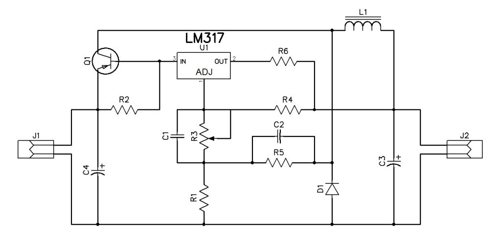

The circuit presented here is based on LM317. Generally, LM317 is known as a linear regulator IC, but here the circuit operates as a switching regulator. This circuit operates by transferring energy
from the input to the output by using a solid state switch. Power Efficiency of a switching regulator is much higher than the linear regulators. The input voltage for this circuit is 8V-35V
and it can produce the output of 1.8V to 32V, that can be varied by using potentiometer R3.
- Input(V): 8VDC to 35VDC
- Output(V): 1.8VDC to 32VDC
- Output load: 3A

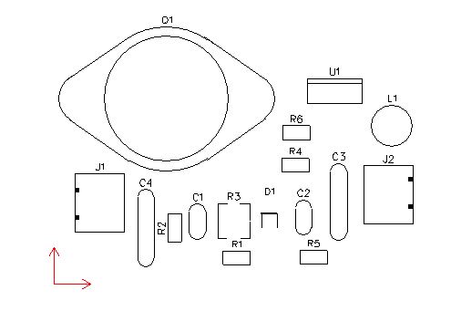

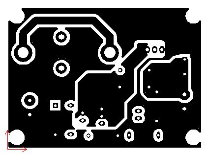

- PCB:68mm X 50mm
Notes
- The real components are not same as shown in the 3D preview.
Schematic

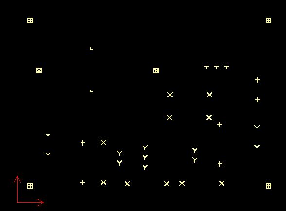

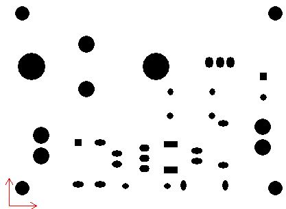

Drill Chart
