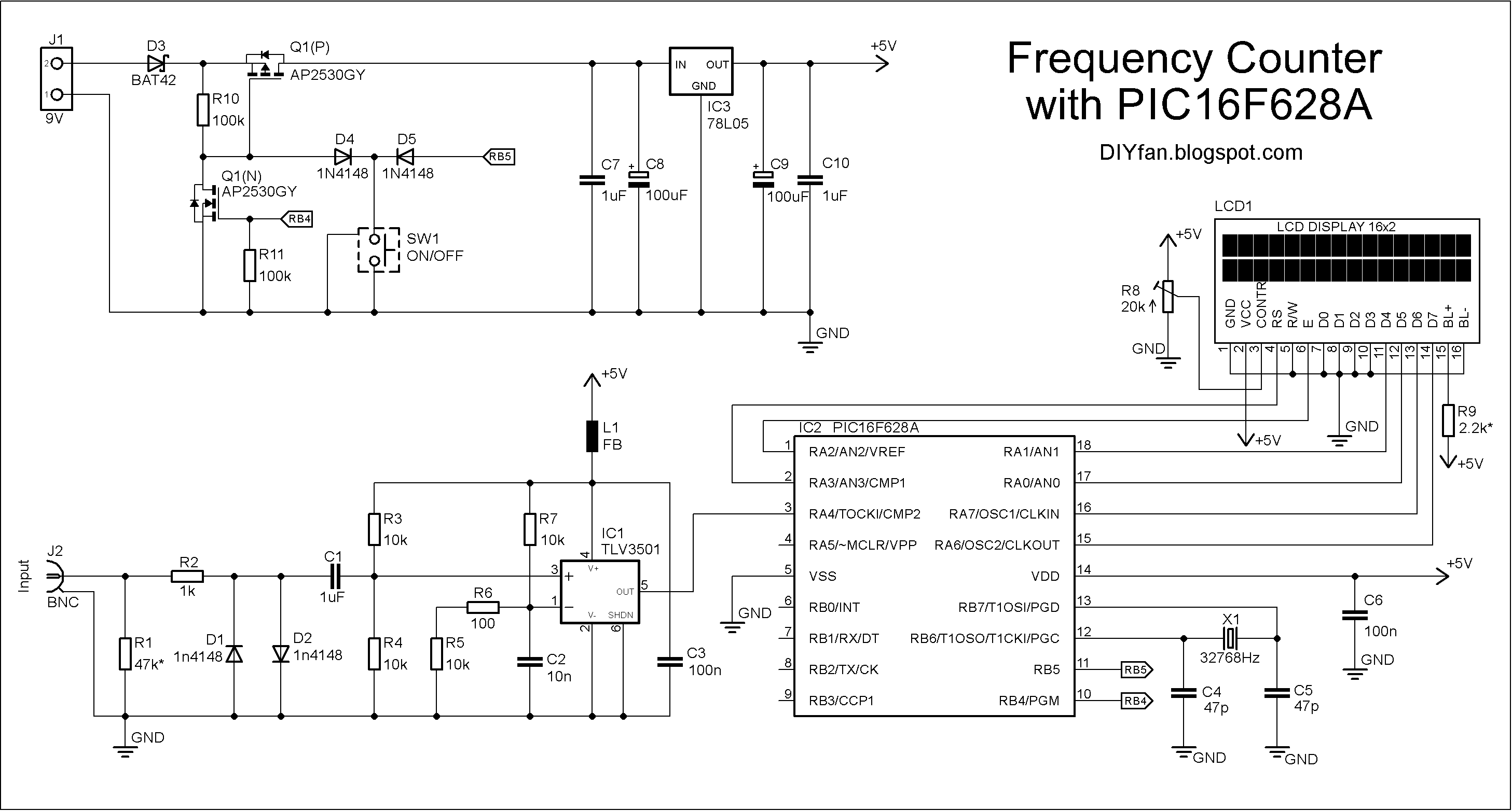

The schematic is fairly simple and straightforward and uses a PIC16F628A microcontroller for measuring frequency and a high speed comparator for signal amplification and conditioning.
The microcontroller uses its internal 4MHz oscillator for the CPU clock. Timer1 uses an external crystal resonator (watch crystal) with 32768Hz frequency for setting the 1 second time base.
Timer0 is used to count the input signal at pin RA4.
The max frequency of Timer0 is 1/4 of the CPU clock which is 1MHz, but there is internal prescaler and it can be set from 1 to 256. In theory this can allow the input signal to be up to 256MHz. On the other hand, in the datasheet of 16F628A there is a requirement for the input pulse at RA4 to be with minimum width of 10ns which is 100MHz frequency. So the maximum frequency can be between 100Mhz and 256MHz. I checked with two different PIC16F628A and they easily go over 200Mhz barrier.
In order to achieve the maximum possible resolution, the input signal is probed for 0.125 seconds and the prescaler value is computed accordingly. This way when input frequency is below 1Mhz the resolution will be 1Hz.
The most important part for the accuracy of the frequency counter is the time base setting circuit – crystal resonator X1 and capacitors C4 and C5. C4 and C5 values can be between 33pF and 62pF and the crystal frequency can be fine tuned with them.
The input of the schematic is feed through a high speed comparator. In order to switch with 100+ Mhz frequency the comparator must have propagation delay bellow 5ns. In this schematic I used Texas Instruments TLV3501 with 4.5ns delay. This was cheapest high speed comparator I was able to find (2.5 euro).
The two inputs of the comparator are set at about 1/2 of power supply voltage with 15-25mV difference between them so any AC signal with higher voltage will start switching the comparator.
If there isn’t input signal the output of the comparator stays low. If we connect a signal source to the positive input, when the signal goes over +20mV the comparator switches high (5V), when signal goes bellow +20mV comparator switches back to 0V. So whatever signal we fed to the input, the output is square wave 0V-5V with the same frequency as the original signal.
The output of the comparator is fed directly to the RA4 pin of the microcontroller.
The input is protected with 1k resistor and two diodes limiting the voltage to ±0.7 V. The input impedance for low frequencies is equal to R1 – 47k. For VHF range maybe it is good idea to replace it with 50 Ohm value.
The schematic can be powered by 9V battery or any other DC voltage from 7V to 15-20V. LM78L05 or LM2931-5.0 IC is used for regulating the voltage down to 5V. There is simple soft ON/OFF circuitry with a dual P- and N-MOS transistor. When button is pressed the P-MOS transistor is switched on and the microcontroller is powered and its first instruction is to set RB4 high which switch the N-MOS transistor on and the power stays on. If the button is pressed again RB5 goes low and the microcontroller sets the RB4 low and this way switch the power off. The microcontroller also auto switch the power off after a certain amount of time (3min 40sec).
The schematic have fairly low power consumption – with no input signal the supply current is 7-8mA and goes up to 20mA with 200+MHz input signal. If the display is too dark, the back light can be adjusted by decreasing the value of the R9 resistor. This of course will increase the current consumption.

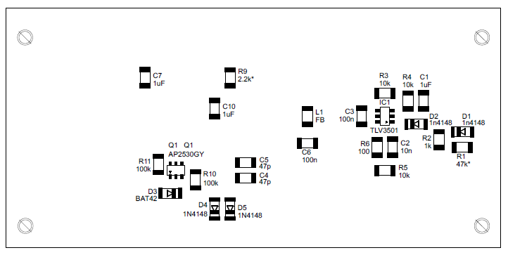

which it is the value of L1 FB
This is a simple ferrite bead for limiting the noise injected to power net. If you don’t have a ferrite bead use a simple wire.
The power wire pull across a ferrite ring.
Hello I want to make this, but have a problem!
I can’t find AP2530GY mosfet available. Market says it is not available anymore. Should I change the model and edit the PCB work?
Also, is there any trade offs between this version and https://www.electronics-lab.com/project/100mhz-frequency-counter-with-pic16f628a/ (LED) version?
LED version seems easier to make, and have same frequency resolution. If the spec is similar, I am thinking to work on LED version.

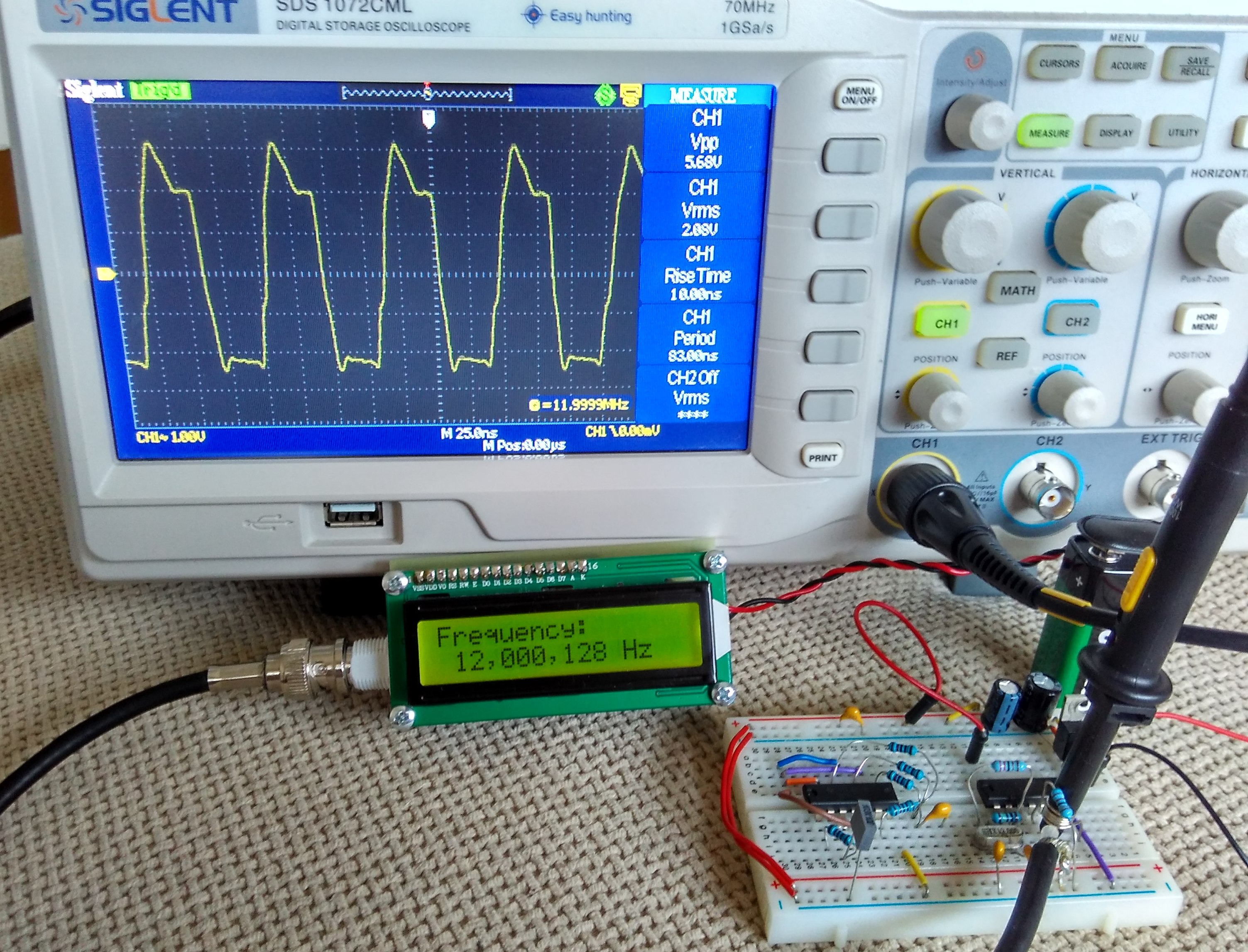

Now, the circuit is working and counting frequency TILL 87MHz ONLY as soon as I give 88MHz to its input, the measured value drops and starts giving wrong frequency.
Can you suggest why I am into this limit while you were able to measure till 200MHz? Actually my frequency range of interest is 100MHz to 200MHz.
I have made some changes in my circuit compared to yours, these changes are as follows:
1. No ON/OFF switch and its corresponding circuitry, directly feeding the power through 7805 chip with caps
2. Using SMD version of all components including PIC, caps and xtal etc. No through hole so my PCB is single sided only
3. Not using 4148 Diodes (keeping input amplitude = 300mV)
4. Using R1=50 ohm instead of 47k as my oscillating circuit has O/P impedance of 50 ohm
5. Using 12pF caps instead of 47pF (I just noticed it but I can replace them)
What do you think, can anyone of above changes cause any trouble in frequency range?

I am using 12pF cap with crystal because this is what is suggested by the XTAL datasheet.
Regarding frequencies over 80Mhz I am suspicious that only some pics will respond. I intend to use an external prescaler divide by 10 which works to more than 1Ghz. I chose MC12080(ebay). In this case little or no modification will be required to the code since you can figure out the reading easily. this prescaler only needs a few capacitors and one resistor to work. A small circuit diagram is available if you need it.
Regarding the power off circuitry I have not included it as the whole thing works from a small 5v power adapter.
“So the maximum frequency can be between 100Mhz and 256MHz.” That statement seems incorrect, but hey, I don’t know much about the PICs. So who am i to argue.

Hello ,
Im relative new to electronics and im trying to understand the schematic, but what purpose does the capacitor c1 serve? is it for filtering or something else?
Hello and welcome! C1 is used to block any DC voltage that may appear on the input signal and allow only AC to pass.
Ah i see. I have another question is iτ possible to swap the PIC16F628A for an arduino? if so do i need some kind of prescaler circuit before the input of the arduino?
You may use Arduino instead of PIC but the source code must be re-written.

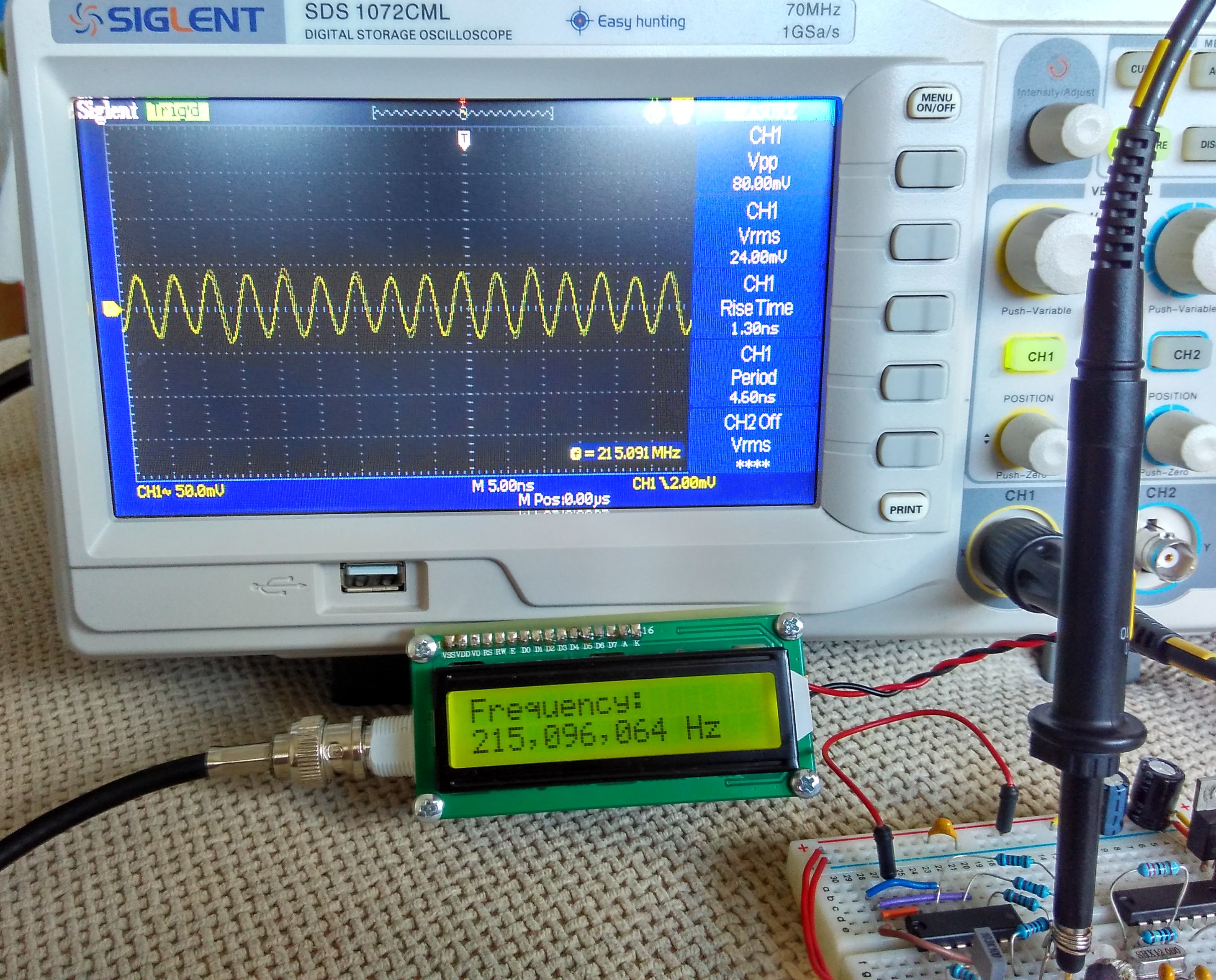

Two problems with that TLV3501 comparator: the max guaranteed toggle rate is 80MHz, and at low speeds (below ~50KHz) you may have unavoidable chatter on the output as noise on input or power is interpreted as an edge, especially so on a single-layer board like this. The default hysteresis for that part is only 6mv, so you might want to review the section on the datasheet titled ‘Adding external hysteresis’. You might also want to consider swapping that comparator out for an ECL prescaler like the MC12080, with a transistor output buffer to get the output up to a decent logic level.
I don’t want to be offending, but am afrid, the high limit of your frequency counter is way overestimated.
A short blink on the datasheet reveals that the shortest pulse width of the input signal, for Timer0 counter in the PIC16F628A, is 10 ns. A period contains two pulses, one positive and one negative, so the highest specified frequency is 50 MHz. A practical value can be higher than that, but 100 MHz is very unlikely, let alone the 200 plus MHz. You state more than one PIC628A-based counter you built was able to measure frequencies beyond 200 MHz. Hard to believe that. This would mean around 2.3 ns input pulse width…
I can see the proof on an oscilloscope screen. I am curious to know, what IC on the breadboard produces the more than 215 MHz test signal. That must be an ECL device, or perhaps one off the 74G series, however, achieving 200 plus MHz with such build technology leaves questions.
In one of the comments Mr. Karimi observed the highest frequency limit being 87 MHz, that seems fully reasonable.
Could you ease my doubts and anxiety, please? Thanks in advance,

I made this frequency counter and tested it. The input fed the frequency from the si5351 and he measured the frequency up to 250MHz. If you apply more frequency, the changes become incorrect. What the maximum frequency is limited by: firmware pic16f628a, tlv3501 maximum or pic16 TMR0 maximum.
The maximum output frequency of the SI5351 is 133MHz, according to its datasheet. How did you achieve 250 MHz?
This can be achieved by overclocking the SI5351, which is not recommended for sensitive circuits.

My si5351a module ordered from aliexpress stably generated frequencies up to 310 MHz. I controlled the si5351 library with the help of arduino, corrected since the adafruit library did not allow dividing the frequency by 4. I took the corrected si5351a library from the github, you need to search. Also on this frequency meter, I reassigned the ra6 and ra7 pins and connected a 20 MHz quartz to these pins and launched the microcontroller on this quartz. Now the maximum frequency that I could measure stably is 268 MHz. At frequencies of 272~275MHz, the frequencies jump by 1~2MHz.
