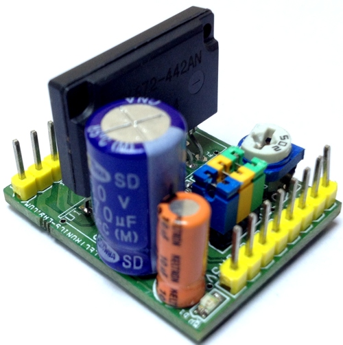

Unipolar stepper motor driver can drive unipolar motor up to 3.5A and supply range 10 To 50V DC. The board has been designed using STK672-442AEN IC. The STK672-442AN is a hybrid IC for use as a unipolar, 2-phase stepper motor driver with PWM current control and Micro-stepping.

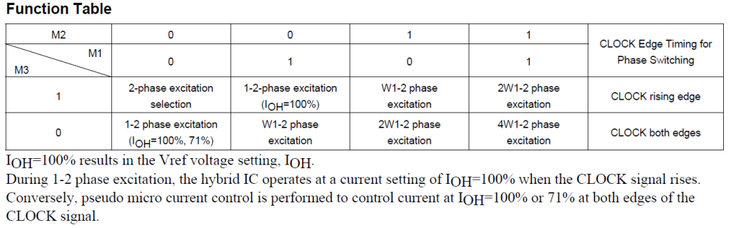

- External pins can be used to select 2, 1-2 (including pseudo-micro), W1-2, 2 W1-2, or 4W1-2 excitation.
- Clock Input : Input frequency 20Khz when using both edge, Or 50Khz when using one edge
- Minimum pulse width 20us When using both edge Or 10us when using one edge
- M3: Jumper J3-Open the excitation phase moves one step at a time at the rising edge of the CLOCK pulse.
- M3: Jumper J3-Closed the excitation phase moves alternately one step at a time at the rising and falling edges of the CLOCK pulse.

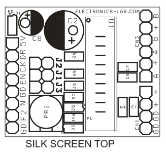

Connections, LEDs and Jumpers
CN 1 : Supply Input up to 50V DC
CN2 : 1 Pin 5V DC, 2 Pin Direction, 3 Pin Clock Input, 4 Pin Enable, 5 Pin GND, 6 NC, 7 Pin FLT2, 8 Pin GND
CN3 : Stepper Motor Connection
D1 LED : Excitation Monitor ( Motor Pulse Indicator)
D3 LED : Power LED
D2 LED : Fault 1 LED On When Over Current, Over Heat
Jumper J1, J2 Micro-Stepping
Jumper J3 The Switch timing of the 4-phase distributor can be switched by setting an external pin (Mode3) to detect either the rise or fall, or rise only, of clock input.
