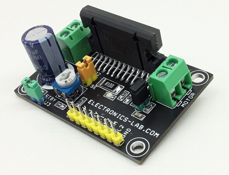

4.5A H-Bridge DC Motor Driver Module Using TB6549HQ

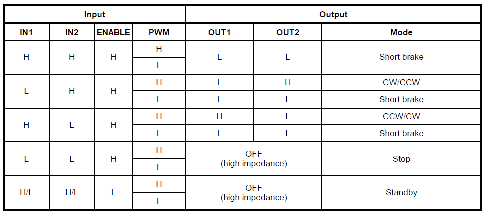

The H-Bridge Motor Driver Module Based on TB6549HQ IC from Toshiba, is a full-bridge driver IC for DC motors that uses an LDMOS structure for output transistors. High-efficiency drive is possible through the use of a MOS process with low ON-resistance and a PWM drive system. Four modes, CW, CCW, short brake, and stop, can be selected using IN1 and IN2. Supply input 12V to 30V DC and Maximum Load 4.5Amps.
Specifications
- Power supply voltage: 30 V (max)
- Output current 4.5 A
- Low ON-resistance: 1.0 Ω (up + low/typ.)
- PWM control capability
- Standby system
- Function modes: CW/CCW/short brake/stop
- Built-in overcurrent protection
- Built-in thermal shutdown circuit
