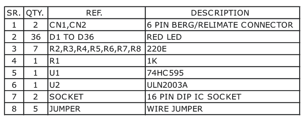

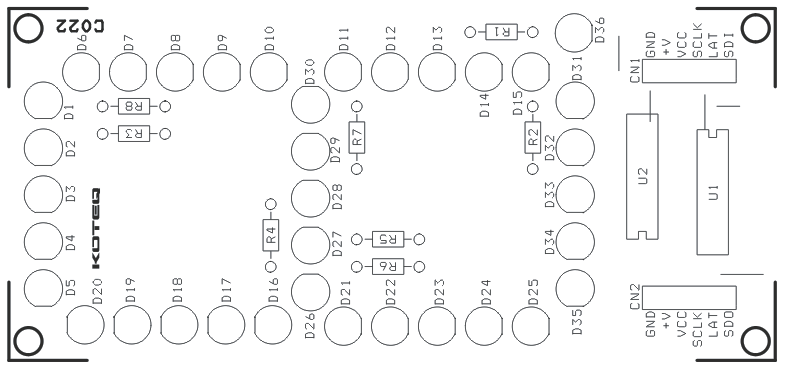

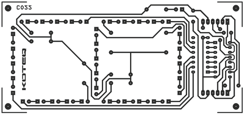

- A ULN2003 IC helps sink higher current flowing through the LEDs to grounds.
- Resistor R1 to R8 are current limiting Resistors for the LEDs connected in series.
- CN1 Connector is Data In connector
- CN2 Connector is optional Data Out Connector if you need to stack more than 1 single display board in series
- +V CN1 & CN2 should be connected to higher voltage to drive the LEDs
- VCC Should be connected to 5V DC. This supply can be source from host controller
- Each Segment made up of 5LEDs
- Series Current limiting resistor provide on each segment
- Series latched type display using SPI protocol
- Separate Header Connecter for connection input/output
- Four Mounting holes 3.2MM each
- PCB Dimension’s 125MM X 58MM
