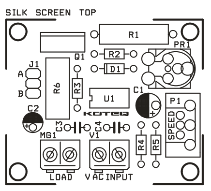

How can I adapt this circuit to a voltage of 127 volts, being Neutral and Phase?
Thankful
Reduce the R1 resistor to around 11K if you are only using 115V.AC.
Dave R.
Thank you so much, Dave. Your help is of great value.
I want to get the components as soon as possible
Claudemir, if you are building the circuit on your own board, you could use a reactive feed to power it.
By replacing the R1, power resistor with an X2 RC cap of 0.22uFx100 ohm and placing a diode across it facing the opposite way to the D1.
This would reduce the heat wasted in the resistor. I have used this method for other mains control chips, in the past.
Just a thought.
Dave.
