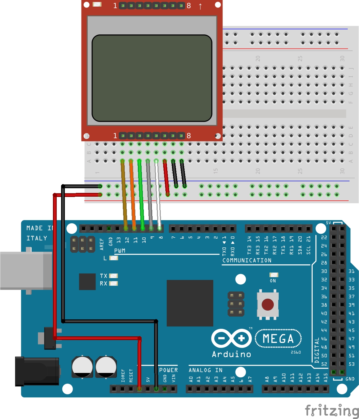

To interface with a micro controller and power itself, the display has two parallel 8-pin port to which headers pins can be connected. You can pick one of the sides and solder header pins to it for connection to the Arduino board.
There are two main power sources needed. The first one is the operational power supply which according to the data sheet should be between the range of 2.7V to 3.3V. The second power supply is required for the LCD back-light. The LCD circuit has no current limiting resistor inbuilt so its better to play safe and only power with 3.3V max.
The LCD is connected to the Arduino as shown in the Schematics below.
![](https://www.electronics-lab.com/wp-content/uploads/2017/12/Nokia-5110-877x1024.jpg)
The connection is illustrated below.
Display - Arduino Pin 1(RST) – D12 Pin 2(CE) – D11 Pin 3(DC) – D10 Pin 4(DIN) – D9 Pin 5(CLK) – D8 Pin 6(VCC) - VCC Pin 7(LIGHT) - GND Pin 8(GND) - GND

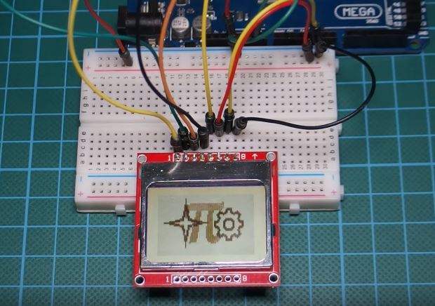

Copy the code, paste in the Arduino IDE, and upload to your Arduino board, you should get an output like the image below on your screen. Don’t forget to include the Graphics.c file in the Arduino sketch folder.

Hi. In your previous and interesting article about Nokia 5110, you have shown a Fritzing picture of the wiring. These wires are connected into a different way respect the sketch and also respect the Fritzing picture used in this article. Could you tell me how much freedom permit the library, choosing the pins of Arduino?
Thank you.
Hi, Thanks for your comment. in most siltuations, fritzing schematics are just representatives as the exact replica of that particular component may not be available on fritzing. This is the reason why i add the pin maps. To really know how the components should be connected, you can use the pin maps.
regards.
