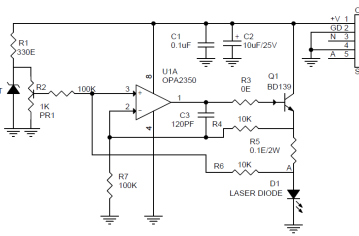

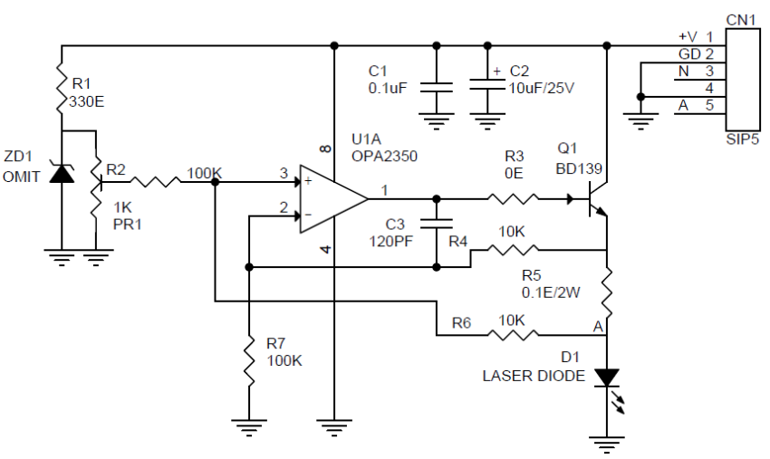

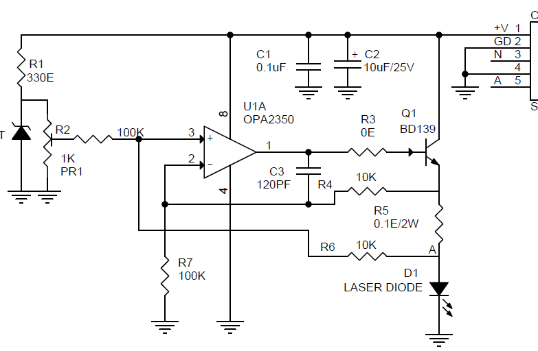

Constant Current Laser Diode Driver Circuit Using OPA2350 OpAmp
[Customadds id=643821] The voltage-controlled current source circuit can be used to drive a constant current into a signal or pump laser diode. This simple linear driver provides a cleaner drive current into a laser diode than switching PWM drivers. The basic circuit is that of a Howland current ... Read More
