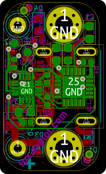

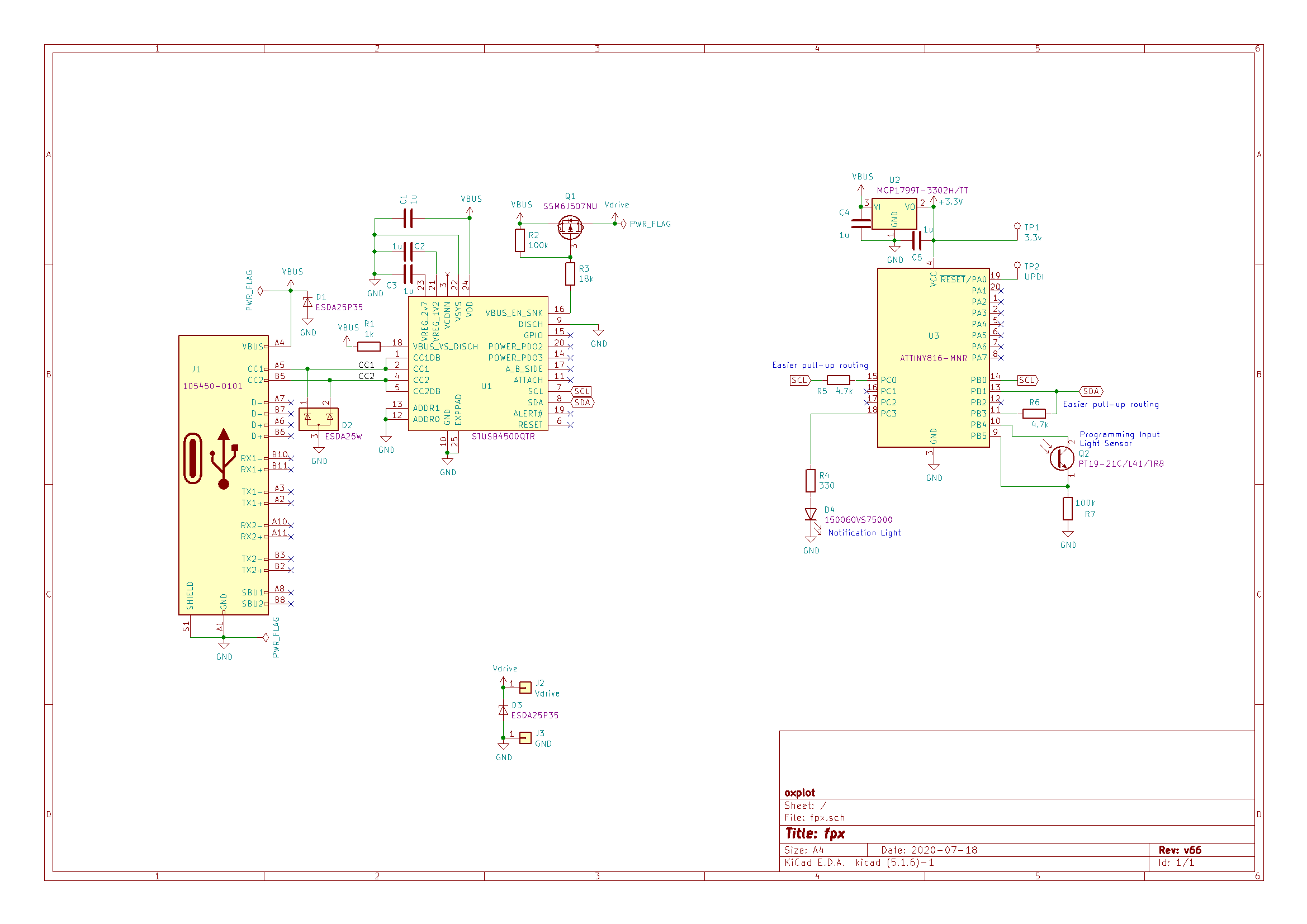

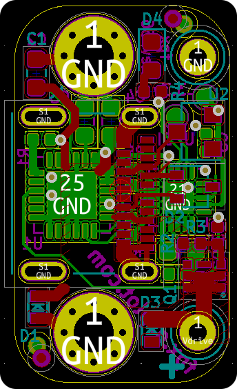

Schematic
fpx board is designed using the amazing KiCad. The design files here are ready for manufacturing and they include part numbers as well.

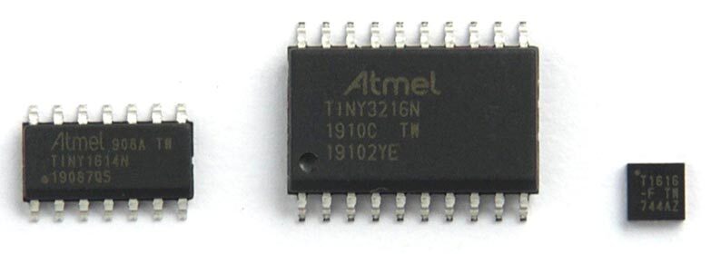

fpx runs on ATtiny816 which is programmed over a single wire UPDI interface. It can be programmed and live debugged using Atmel ICE. fpx exposes UPDI, along with output of the 3.3v linear regulator as test points. Together with the ground terminal, it’s all that’s needed to
program and debug the board using Atmel ICE.
