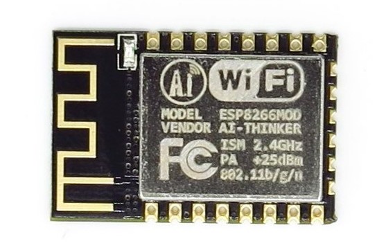

The NodeMCU board is essentially a breakout/development board for the ESP12E module by AI-thinker.
![ESP-12E](https://www.electronics-lab.com/wp-content/uploads/2018/10/1481155742193615729.jpg)
The ESP-12E itself, just like the previous modules, was difficult to work with, due to factors including: breadboard unfriendliness, it requires header pins that were not common on the market, and the only solution to these problems, that was envisioned at the time, was an adapter coupled with an FTDI breakout board and some other connections to make it breadboard friendly and easy to program.
The NodeMCU was the product of that search, incorporating all the required components on a single breadboard friendly, ready to use board while retaining the low cost with which the ESP-based boards were associated.
