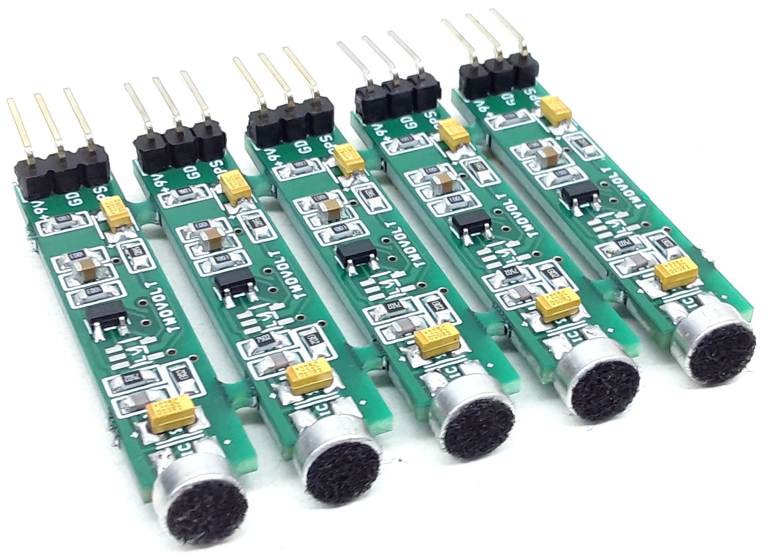

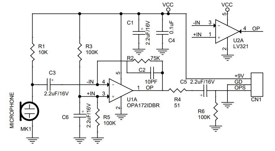

This single supply microphone pre-amplifier amplifies the output signal of an electret capsule microphone to audio line levels. An op-amp is used as a trans-impedance amplifier to convert the output current from the microphone into a signal-level voltage. The circuit works with 9V so it is a good choice for battery-operated systems.
- Supply 9V DC
- Current Approx. 3mA
- On-Board Microphone
- Very thin and narrow PCB
Schematic

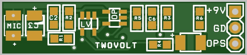

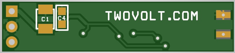

Version v.2 with LV321
This v.2 of the above-board provides an additional option to use LV321 OPAMP in case you can’t find the OPA172. The board has two OPAMP footprints, and you should solder only one. If you use LV321 OPAMP, then the maximum input Vcc=5Vdc. If you use OPA172 OPAMP, then the maximum input Vcc=36Vdc.

the capacitor C5 is well polarized in the diagram, or is it a misprint
Thanks for noticing this fault. We fixed it above in schematic
