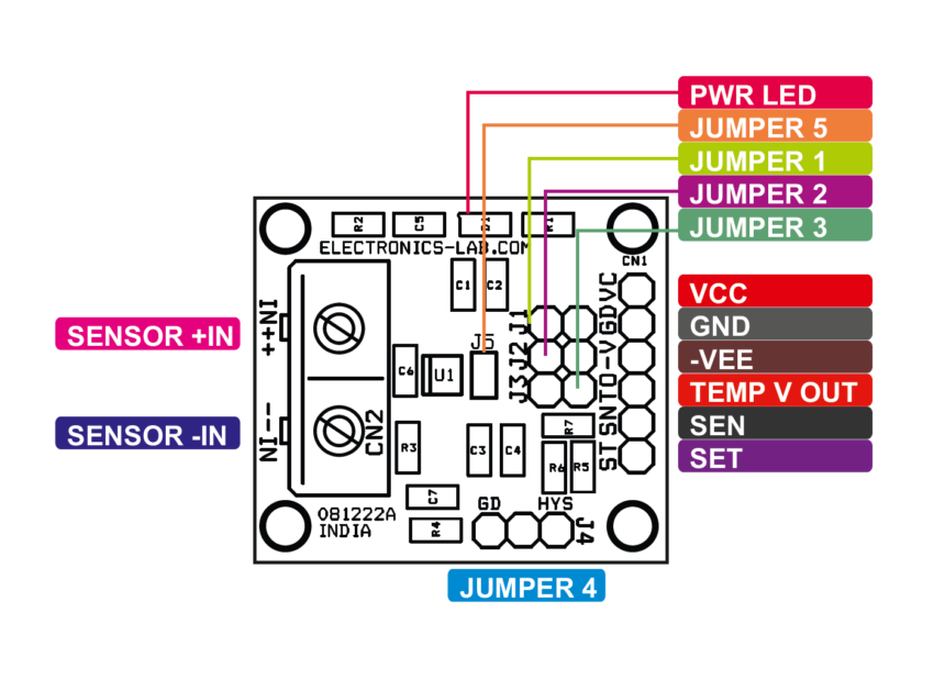

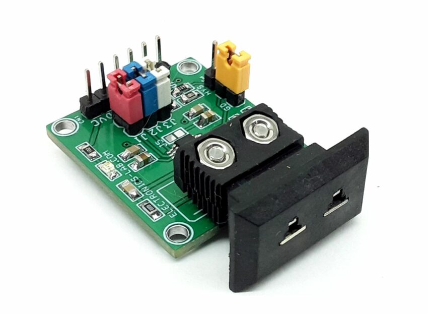

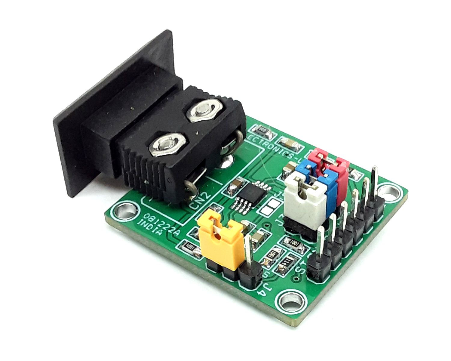

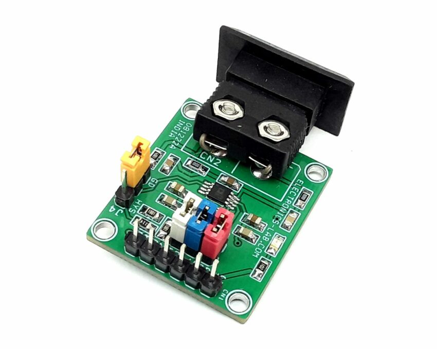

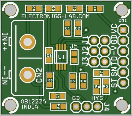

Connections and Other Details
- CN1: Pin 1 = VCC +5V DC, Pin 2 = GND, Pin 3 = -VEE -5V, Pin 4 Temperature V-Output, Pin 5 = Sense (No Use), Pin 6 = Set Point V-Input
- CN2: Pin 1 = K Type Sensor + Input, Pin 2 = Sensor -Input
- Jumper J1: For Set the Linear Output
- Jumper J2: For Set Point Input Mode
- Jumper J3: For Hysteresis on Setpoint Controller Mode
- Jumper J4: For Reference Ground or Hysteresis Selection
- Jumper J5: Closed for Single Supply Input, Open for Dual Power Supply Input (Solder Jumper)

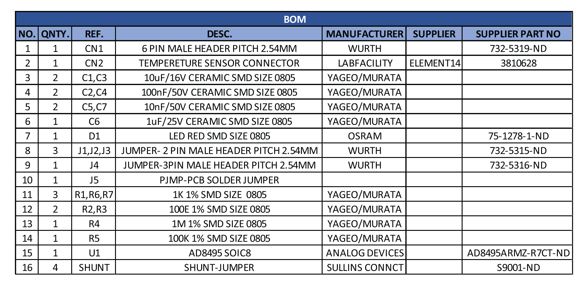

Parts List
NO. | QNTY. | REF. | DESC. | MANUFACTURE | SUPPLIER | SUPPLIER PART NO |
1 | 1 | CN1 | 6 PIN MALE HEADER PITCH 2.54MM | WURTH | DIGIKEY | 732-5319-ND |
2 | 1 | CN2 | TEMPERETURE SENSOR CONNECTOR | LABFACILITY | ELEMENT14 | 3810628 |
3 | 2 | C1,C3 | 10uF/16V CERAMIC SMD SIZE 0805 | YAGEO/MURATA | DIGIKEY | |
4 | 2 | C2,C4 | 100nF/50V CERAMIC SMD SIZE 0805 | YAGEO/MURATA | DIGIKEY | |
5 | 2 | C5,C7 | 10nF/50V CERAMIC SMD SIZE 0805 | YAGEO/MURATA | DIGIKEY | |
6 | 1 | C6 | 1uF/25V CERAMIC SMD SIZE 0805 | YAGEO/MURATA | DIGIKEY | |
7 | 1 | D1 | LED RED SMD SIZE 0805 | OSRAM | DIGIKEY | 75-1278-1-ND |
8 | 3 | J1,J2,J3 | JUMPER- 2 PIN MALE HEADER PITCH 2.54MM | WURTH | DIGIKEY | 732-5315-ND |
9 | 1 | J4 | JUMPER-3PIN MALE HEADER PITCH 2.54MM | WURTH | DIGIKEY | 732-5316-ND |
10 | 1 | J5 | PJMP-PCB SOLDER JUMPER | |||
11 | 3 | R1,R6,R7 | 1K 1% SMD SIZE 0805 | YAGEO/MURATA | DIGIKEY | |
12 | 2 | R2,R3 | 100E 1% SMD SIZE 0805 | YAGEO/MURATA | DIGIKEY | |
13 | 1 | R4 | 1M 1% SMD SIZE 0805 | YAGEO/MURATA | DIGIKEY | |
14 | 1 | R5 | 100K 1% SMD SIZE 0805 | YAGEO/MURATA | DIGIKEY | |
15 | 1 | U1 | AD8495 SOIC8 | ANALOG DEVICES | DIGIKEY | AD8495ARMZ-R7CT-ND |
16 | 4 | SHUNT | SHUNT-JUMPER | SULLINS CONNCT | DIGIKEY | S9001-ND |
Connections

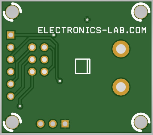

Gerber View

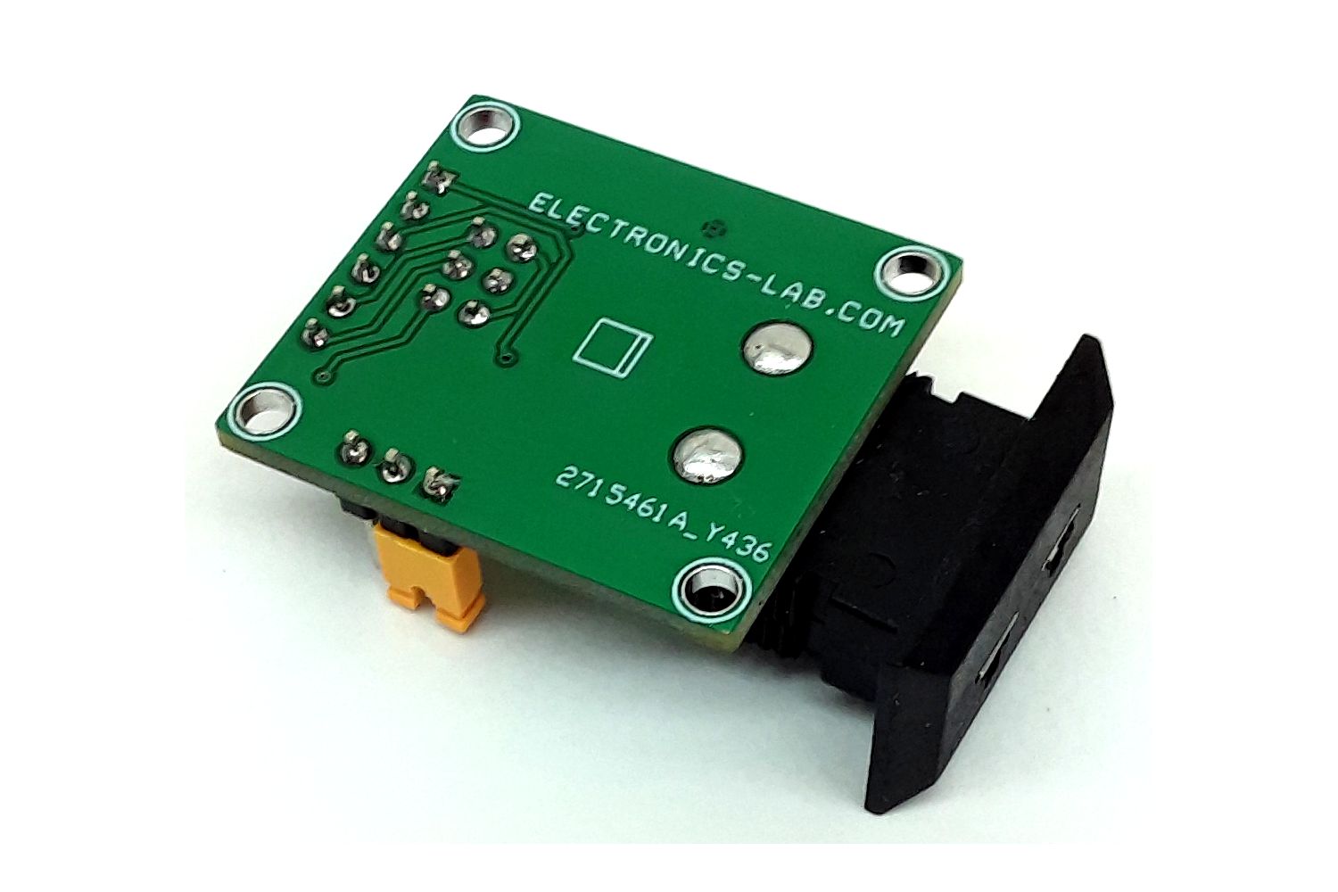

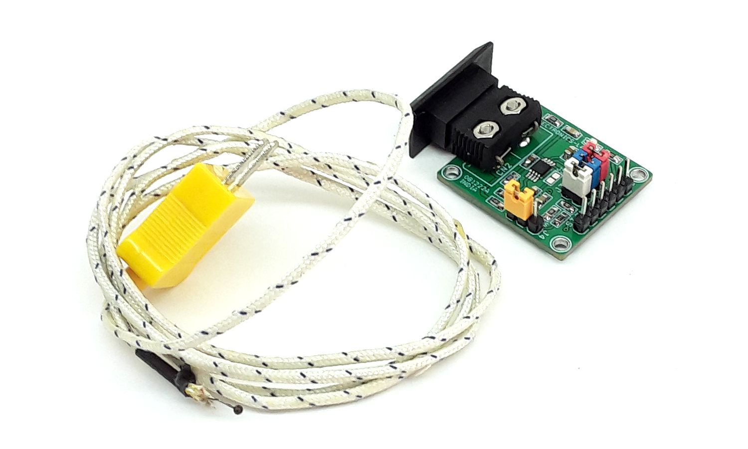

Photos
