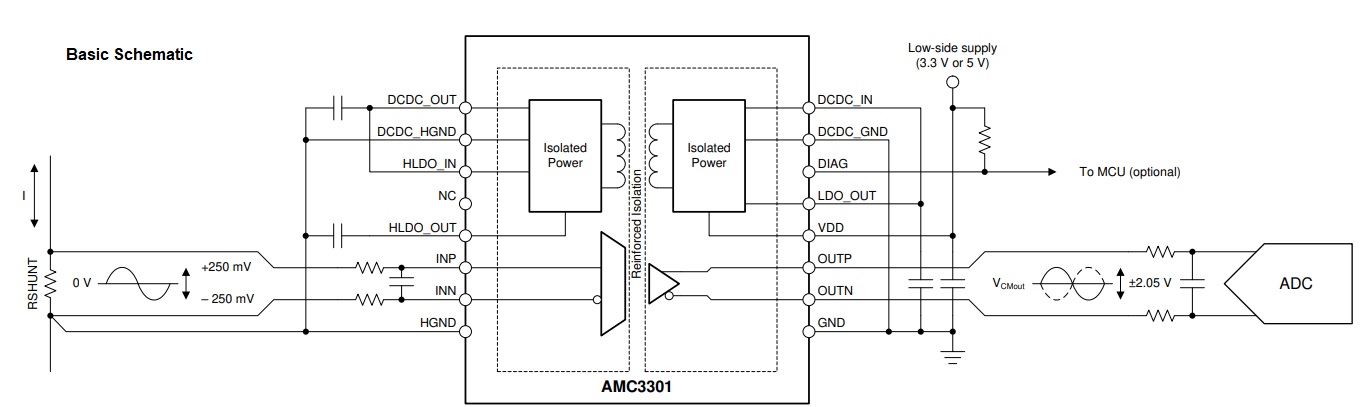

This isolated single-supply bidirectional current sensing project can accurately measure load currents from –2A to 2A. The linear range of the input is from –250mV to 250mV with a differential output range of –2.05V to 2.05V. The gain of the circuit is fixed at 8.2V/V.  The project is based on AMC3301 chip which has a fully integrated, isolated DC/DC converter that allows single-supply operation from the low side of the device. The integrated DC-DC converter saves lots of board space. The reinforced capacitive isolation barrier is certified according to VDE V 0884-11 and UL1577 and supports a working voltage of up to 1.2 kVRMS. The isolation barrier separates parts of the system that operate on different common-mode voltage levels and protects the low-voltage side from hazardous voltages and damage. Output is fully isolated from the input and optimized for high voltage interface. The project provides differential output for easy interface with ADC. Operating Power supply 5V DC.

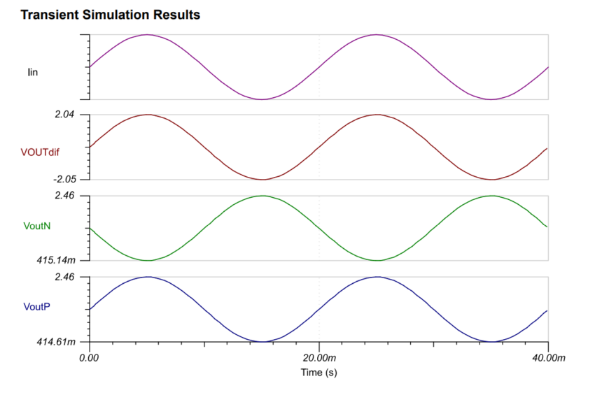

The analog outputs are fully differential signals centered at a common-mode output voltage of 1.44 V. The outputs are available on the header connector CN2 and swing from 0.5 V to 2.5 V when a negative to positive full-scale linear input signal is applied to the input. OUTN swings from 2.5 V to 0.5 V when a negative to positive full-scale linear input signal is applied to the input.

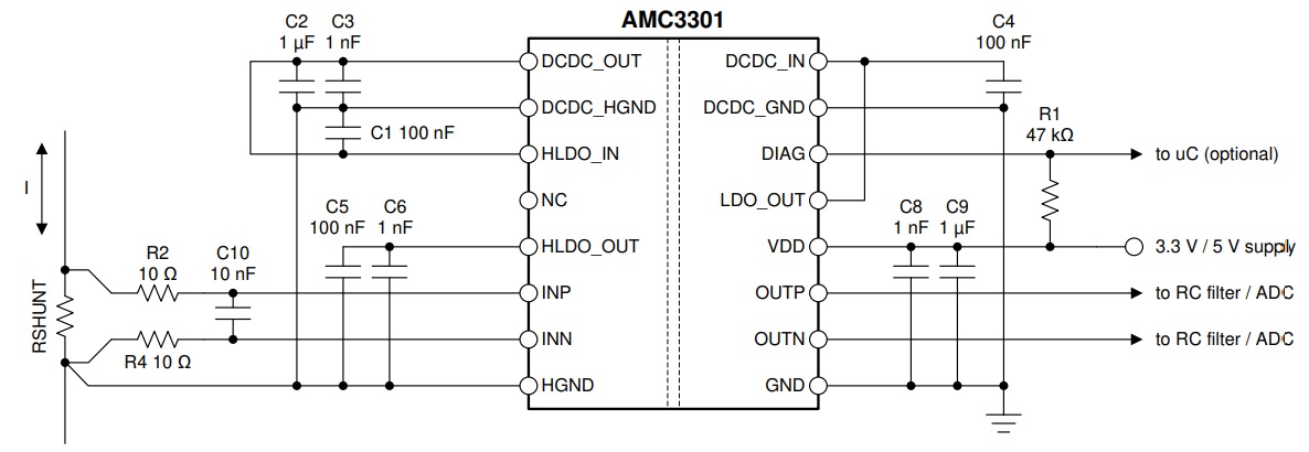

Schematic

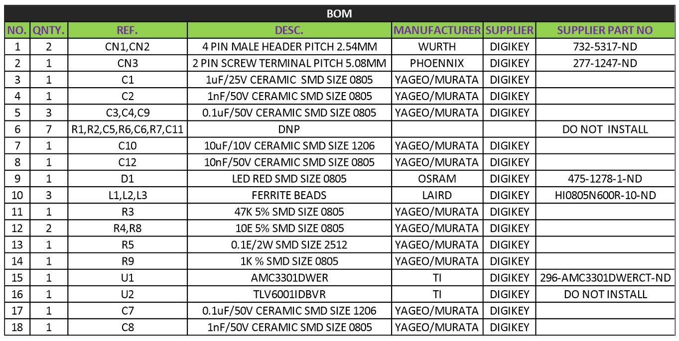

Parts List
NOQNTYREF.DESC.MANUFACTURERSUPPLIERPART NO
12CN1,CN24 PIN MALE HEADER PITCH 2.54MMWURTHDIGIKEY732-5317-ND
21CN32 PIN SCREW TERMINAL PITCH 5.08MMPHOENNIXDIGIKEY277-1247-ND
31C11uF/25V CERAMIC SMD SIZE 0805YAGEO/MURATADIGIKEY
41C21nF/50V CERAMIC SMD SIZE 0805YAGEO/MURATADIGIKEY
53C3,C4,C90.1uF/50V CERAMIC SMD SIZE 0805YAGEO/MURATADIGIKEY
67R1,R2,C5,R6,C6,R7,C11DNPDO NOT INSTALL
71C1010uF/10V CERAMIC SMD SIZE 1206YAGEO/MURATADIGIKEY
81C1210nF/50V CERAMIC SMD SIZE 0805YAGEO/MURATADIGIKEY
91D1LED RED SMD SIZE 0805OSRAMDIGIKEY475-1278-1-ND
103L1,L2,L3FERRITE BEADSLAIRDDIGIKEYHI0805N600R-10-ND
111R347K 5% SMD SIZE 0805YAGEO/MURATADIGIKEY
122R4,R810E 5% SMD SIZE 0805YAGEO/MURATADIGIKEY
131R50.1E/2W SMD SIZE 2512YAGEO/MURATADIGIKEY
141R91K % SMD SIZE 0805YAGEO/MURATADIGIKEY
151U1AMC3301DWERTIDIGIKEY296-AMC3301DWERCT-ND
161U2TLV6001IDBVRTIDIGIKEYDO NOT INSTALL
171C70.1uF/50V CERAMIC SMD SIZE 1206YAGEO/MURATADIGIKEY
181C81nF/50V CERAMIC SMD SIZE 0805YAGEO/MURATADIGIKEY

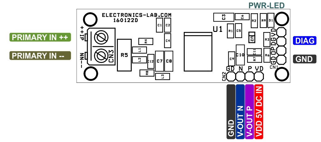

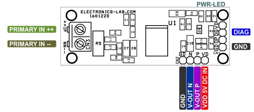

Connections

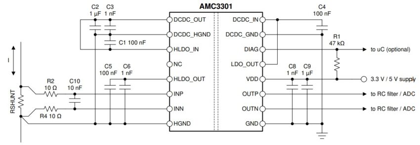

Application Diagram

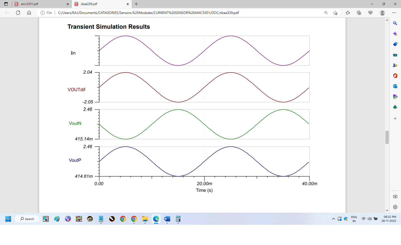

Simulation Results

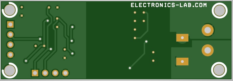

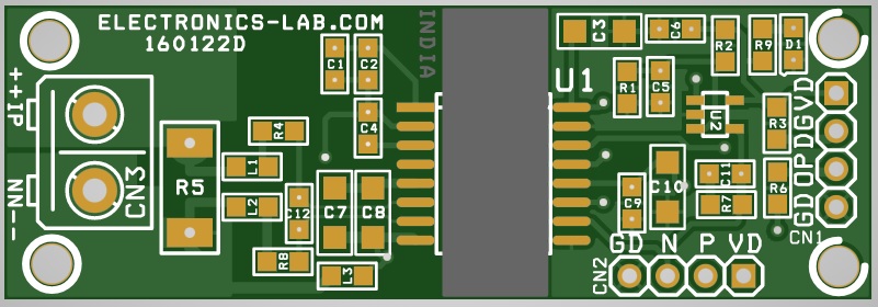

Gerber View

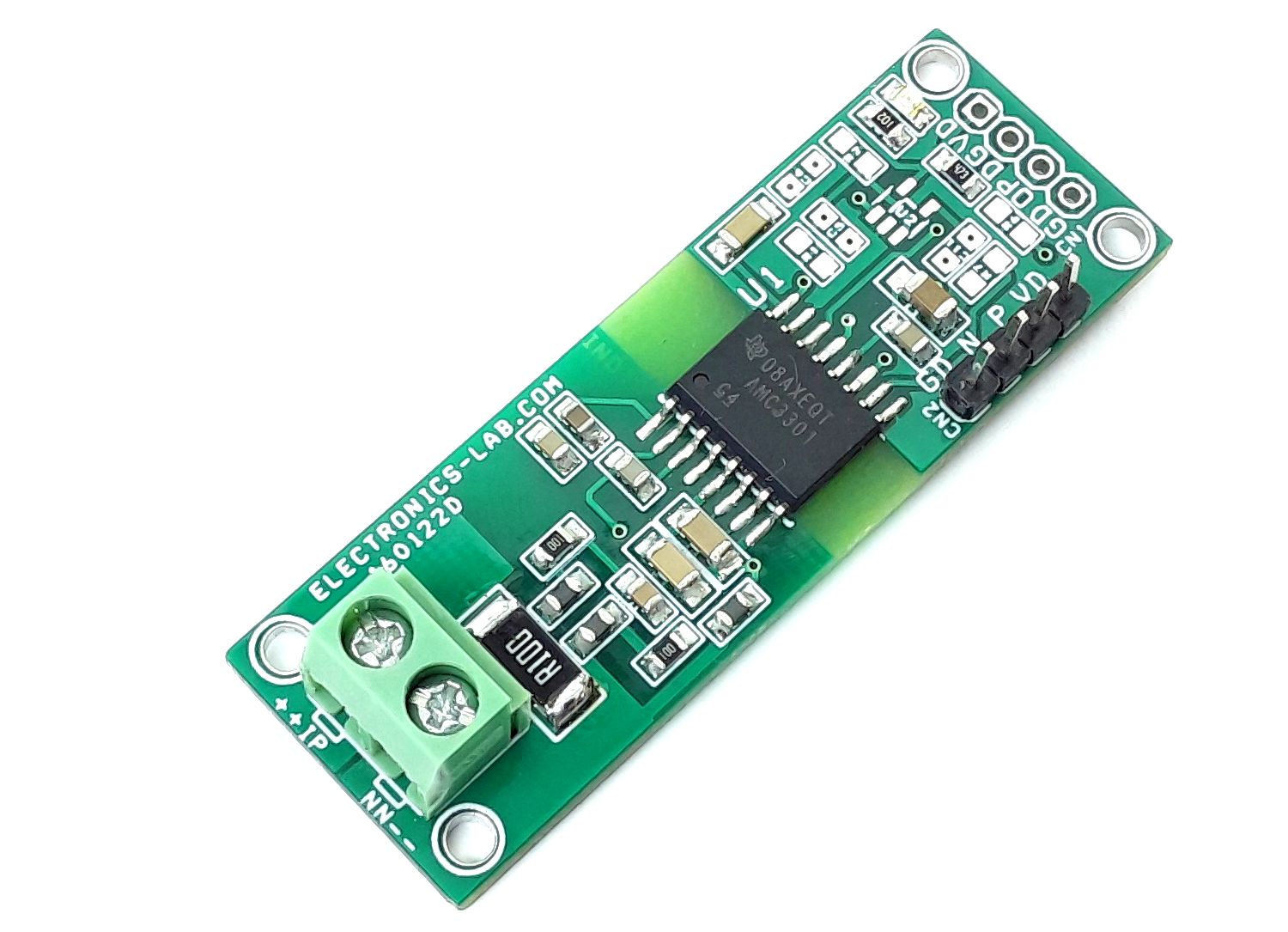

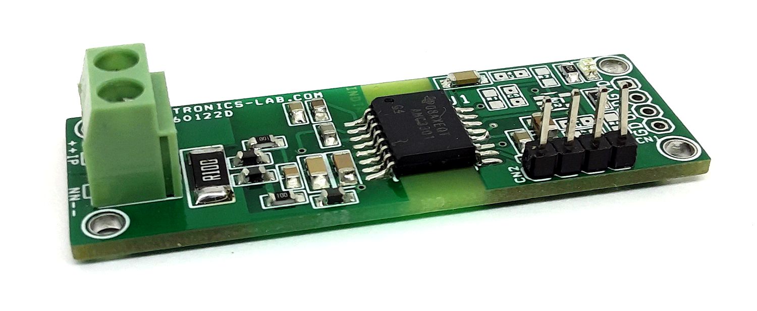

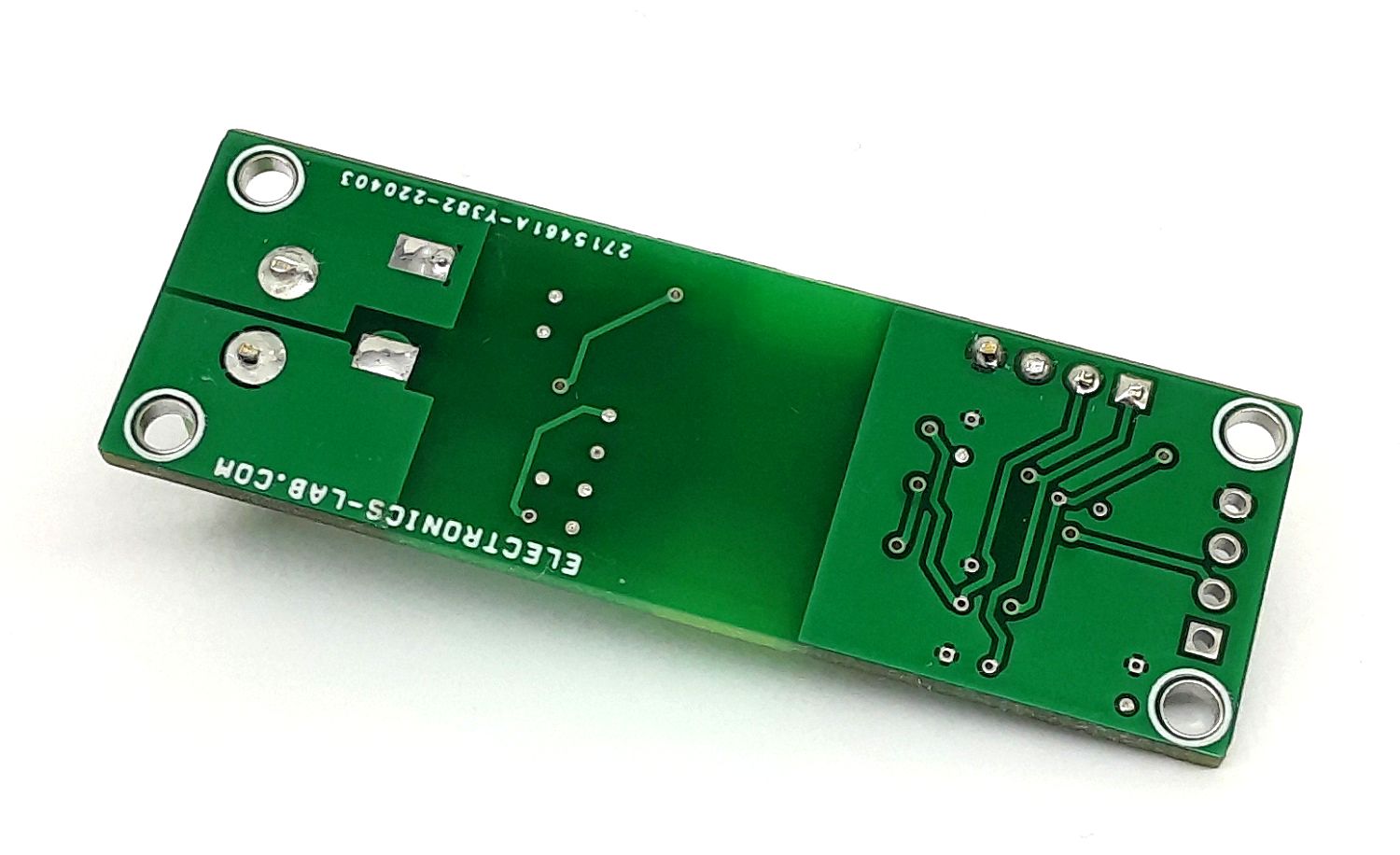

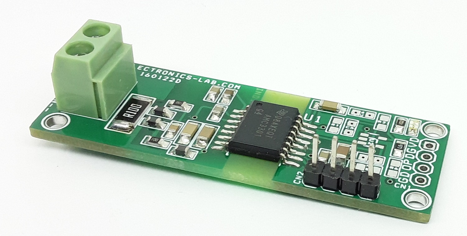

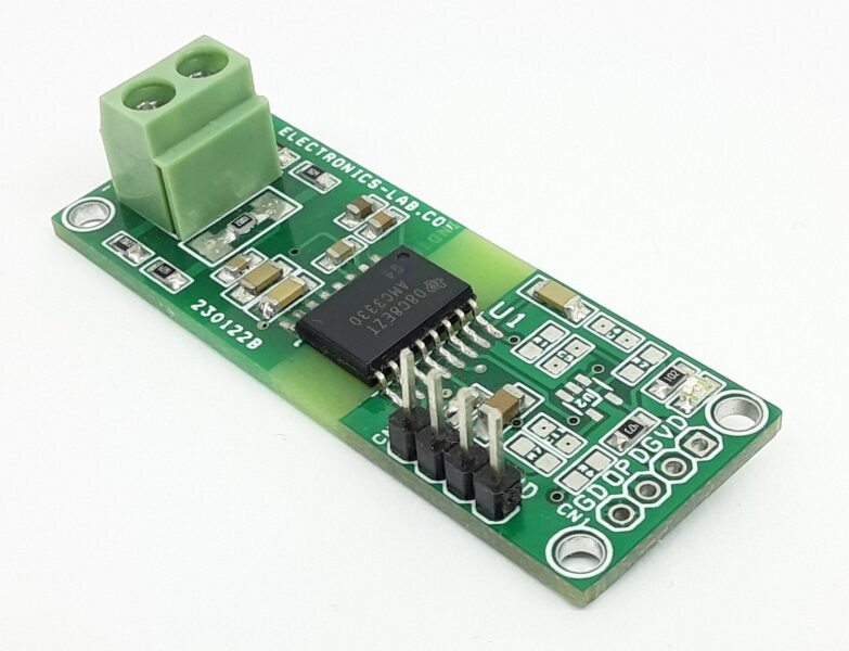

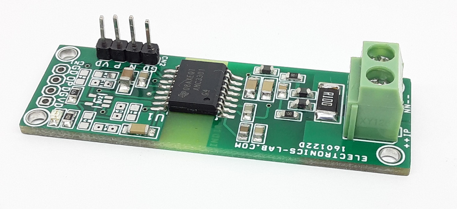

Photos

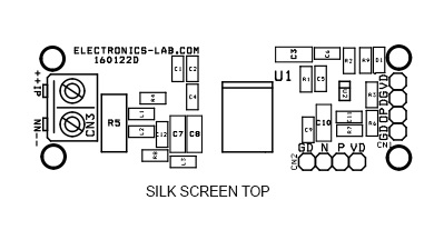

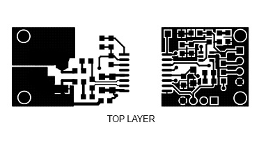

PCB
