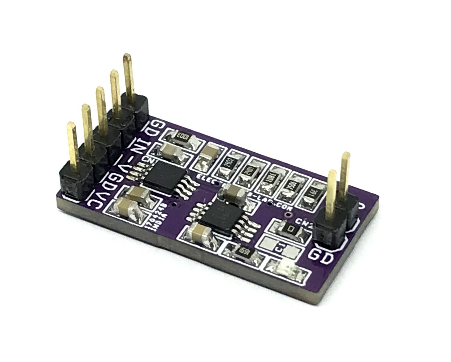

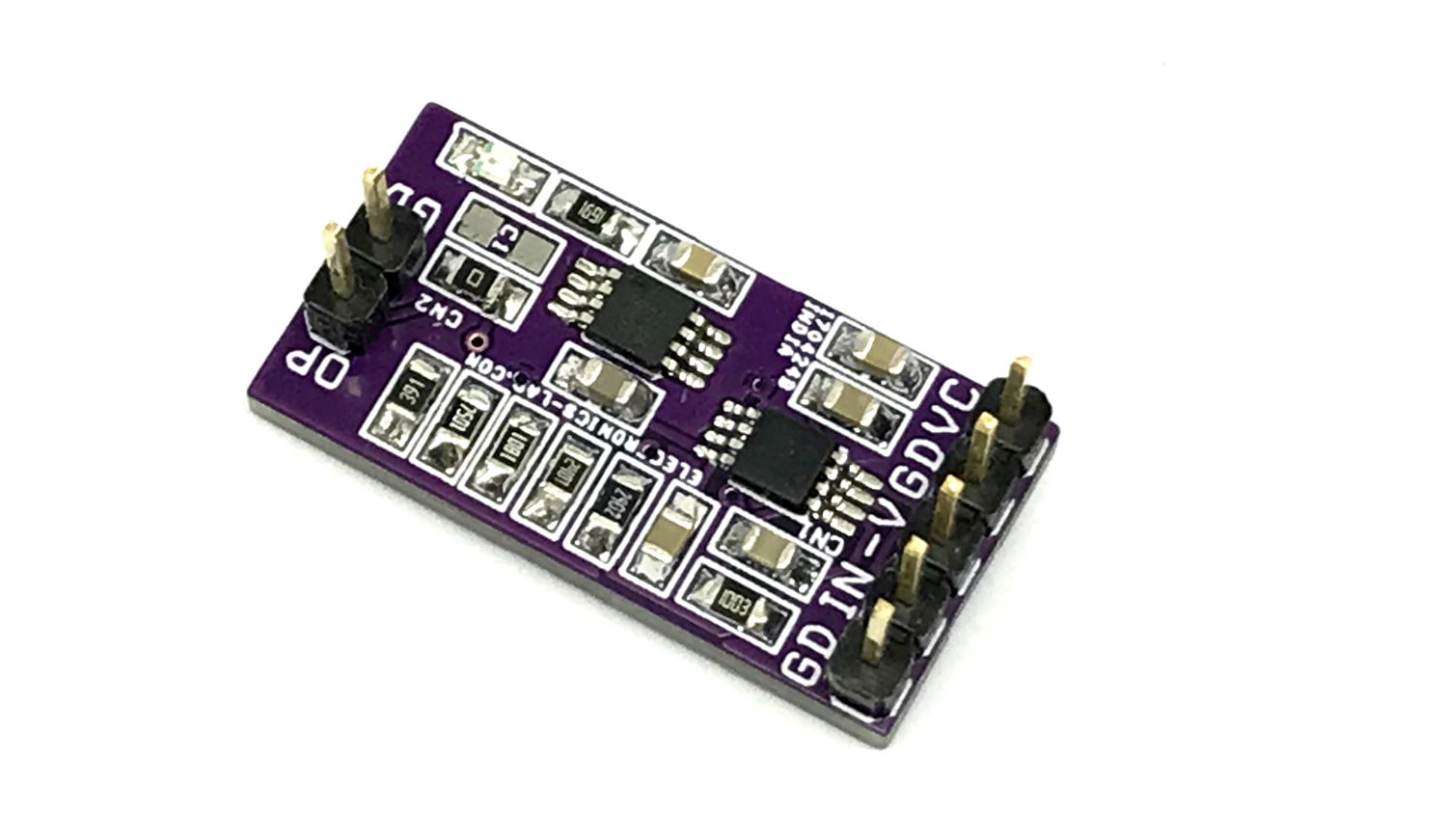

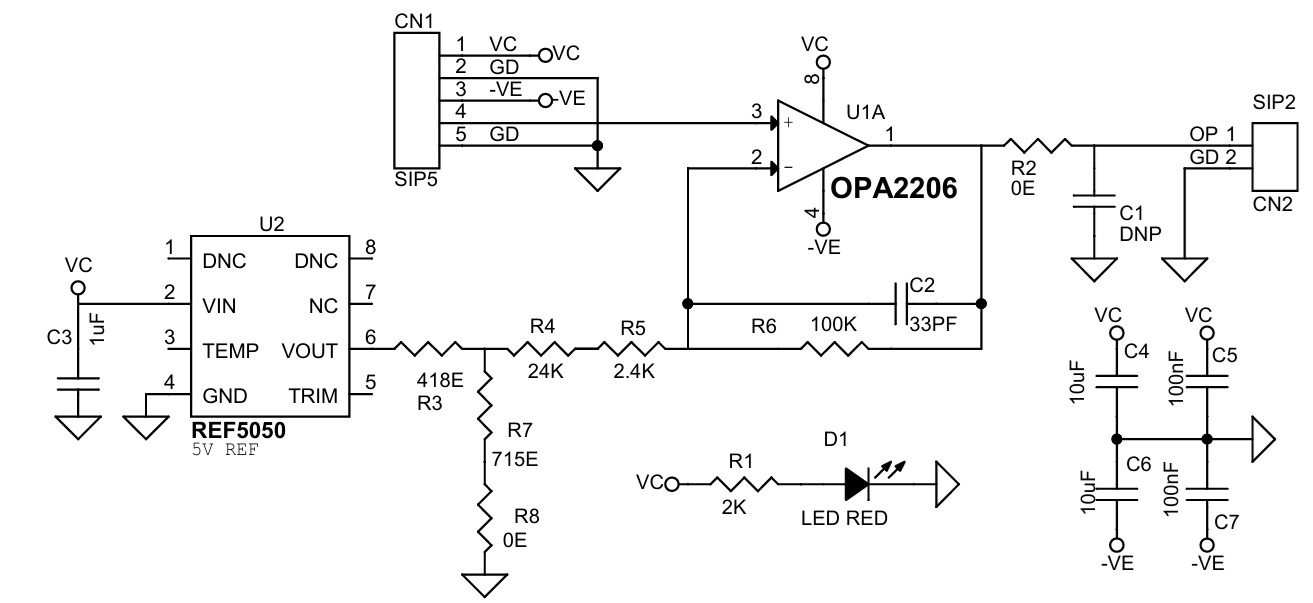

This design is intended to translate a small unipolar signal to a wide bipolar signal. A common application is to translate a 0 to 5V DAC output to a ±10V bipolar signal. All resistors are 1% but it is advisable to select 0.1% 20 ppm/°C resistors for good gain, offset accuracy, and drift tolerance. A calibration at room temperature can be done to minimize the gain error, but gain drift can only be reduced by minimizing the resistor drift (choosing resistors with TC ≤ 20 ppm/°C). The project is built using OPA2206 Precision, bipolar, e‑trim OPAMP. REF5050 provides 5V reference voltage to OPAMP. The board works with a dual ±15V DC Power Supply.
- Power Supply ±15V DC (Dual 15V DC)
- Input 0 to 5V
- Output ±10V (Dual 10V)
- Bandwidth 50Khz
- PCB Dimensions 26.19 x 13.34mm

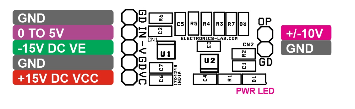

Connections
- CN1: Pin 1 +15V DC, Pin 2 = GND, Pin 3 = -15V DC, Pin 4 = 0 to 5V Signal, Pin 5 = GND
- CN2: Pin 1 = Output ±10V (Dual 10V)
- D1: Power LED

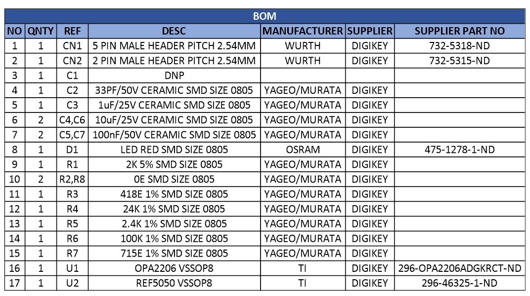

Parts List
NO | QNTY | REF | DESC | MANUFACTURER | SUPPLIER | SUPPLIER PART NO |
1 | 1 | CN1 | 5 PIN MALE HEADER PITCH 2.54MM | WURTH | DIGIKEY | 732-5318-ND |
2 | 1 | CN2 | 2 PIN MALE HEADER PITCH 2.54MM | WURTH | DIGIKEY | 732-5315-ND |
3 | 1 | C1 | DNP | |||
4 | 1 | C2 | 33PF/50V CERAMIC SMD SIZE 0805 | YAGEO/MURATA | DIGIKEY | |
5 | 1 | C3 | 1uF/25V CERAMIC SMD SIZE 0805 | YAGEO/MURATA | DIGIKEY | |
6 | 2 | C4,C6 | 10uF/25V CERAMIC SMD SIZE 0805 | YAGEO/MURATA | DIGIKEY | |
7 | 2 | C5,C7 | 100nF/50V CERAMIC SMD SIZE 0805 | YAGEO/MURATA | DIGIKEY | |
8 | 1 | D1 | LED RED SMD SIZE 0805 | OSRAM | DIGIKEY | 475-1278-1-ND |
9 | 1 | R1 | 2K 5% SMD SIZE 0805 | YAGEO/MURATA | DIGIKEY | |
10 | 2 | R2,R8 | 0E SMD SIZE 0805 | YAGEO/MURATA | DIGIKEY | |
11 | 1 | R3 | 418E 1% SMD SIZE 0805 | YAGEO/MURATA | DIGIKEY | |
12 | 1 | R4 | 24K 1% SMD SIZE 0805 | YAGEO/MURATA | DIGIKEY | |
13 | 1 | R5 | 2.4K 1% SMD SIZE 0805 | YAGEO/MURATA | DIGIKEY | |
14 | 1 | R6 | 100K 1% SMD SIZE 0805 | YAGEO/MURATA | DIGIKEY | |
15 | 1 | R7 | 715E 1% SMD SIZE 0805 | YAGEO/MURATA | DIGIKEY | |
16 | 1 | U1 | OPA2206 VSSOP8 | TI | DIGIKEY | 296-OPA2206ADGKRCT-ND |
17 | 1 | U2 | REF5050 VSSOP8 | TI | DIGIKEY | 296-46325-1-ND |
