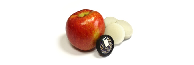

Puck.js Has a Very Small Form Factor

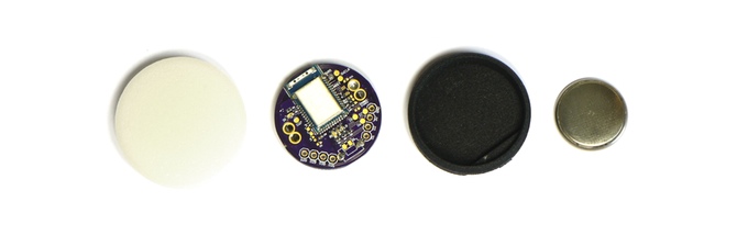

Puck.js has various sensors for different purposes and various kinds of output components. It can measure light, temperature, magnetic fields, and capacitance. This beacon also can control Infrared remote devices, produce any color light using RGB LED, and has a tactile switch that turns the Puck into one big button.
The Magnetometer on Puck.js is a digital compass. You can measure its orientation about the earth’s magnetic field in 3 dimensions. It can also detect a magnet nearby and measures the magnetic field.
Detailed View of Puck.js Bluetooth Beacon
