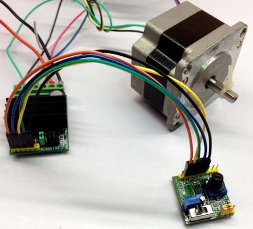

This stepper pulse generator project is an easy solution for stepper controller drive. It’s a very important tool and can be used to drive stepper in standalone mode. It generates square wave pulses in frequency range 0-50Khz. This project has multiple features which are a must for stepper controller. It has on board frequency generator with wide span of frequency, Slide switch for direction control and jumper for enable or disables the stepper controller. AD654 is heart of the project and its generate the pulse for stepper controller, output frequency 0-50Khz, higher frequency output is possible by changing CT capacitor value connected between pin 6 and 7. Refer to data sheet of AD654 for alteration.
