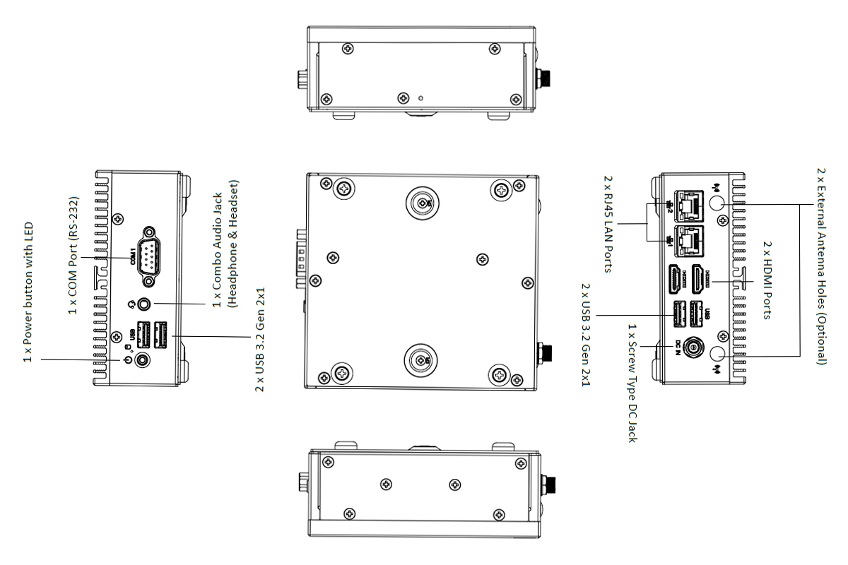

Front Side (left), Rear Side (right), Bottom Side (middle), Left Side (bottom), Right Side (top)

  • I/O Ports:
    • Front: 1x Power Button with LED
    • Rear: 2x RJ45 LAN Ports, 2x HDMI, 2x USB 3.2 Gen 2, 1x screw-type DC jack
  • Expansion: 2x external antenna holes (optional)
  • Mounting: VESA bracket (optional)
  • Dimensions: 118 x 109.4 x 44.4 mm
