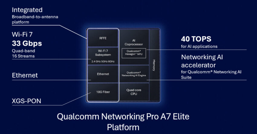

The Qualcomm Networking Pro A7 Elite Platform integrates high-performance Wi-Fi 7 with AI processing, designed for devices like routers, gateways, and access points. It features the Qualcomm Hexagon NPU, delivering up to 40 TOPS of AI processing power, and enabling edge-based AI and generative AI applications. This allows for improved privacy through edge processing, near real-time responses, and better contextual understanding.
With support for up to 33 Gbps peak aggregate capacity, the platform enhances user experiences across applications like streaming and gaming, utilizing AI-driven features. It also simplifies system development by integrating 10G Fiber (XGS-PON), Ethernet, front-end modules, and filters into a single platform. Its compatibility with leading open-source software and middleware helps operators and enterprises develop solutions for security, energy management, health monitoring, and more.

Qualcomm Networking Pro A7 block diagram
