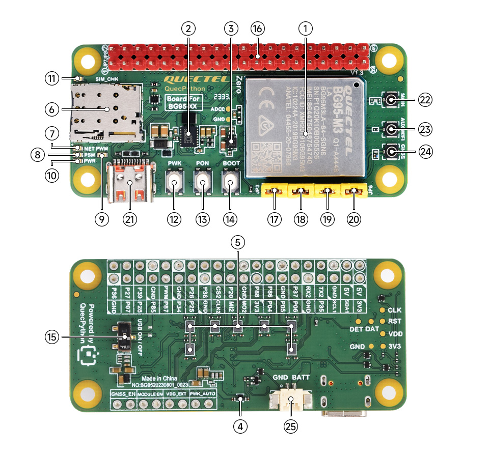

  • BG95-M3 Main Module: Supports LTE Cat M1 / LTE Cat NB2 / EGPRS networking, applicable globally.

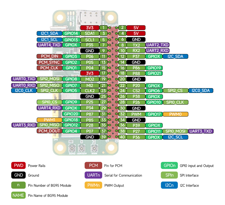

  • 40-Pin GPIO Header: Compatible with most Raspberry Pi HATs.
  • Status LEDs: 5 LEDs indicating module operating status.
  • Type-C Port: Enables easy development with a USB Type-C cable.
  • Protocol Support: PPP, TCP, UDP, SSL, TLS, FTP(S), HTTP(S), NITZ, PING, MQTT, LwM2M, CoAP, IPv6, etc.
  • GNSS Positioning: Supports GPS, GLONASS, BDS, Galileo, and QZSS.
  • Nano SIM Card Slot: Supports 1.8V SIM card, designed for easy insertion/removal.
  • MIPI Interface: Supports MIPI screen and Raspberry Pi peripherals.
  • Camera Interface: Supports customized SPI camera up to 30MP.
  • Development Tools: QPYcom, Thonny IDE plugin, VSCode plugin.
  • Power Supply: 5V via USB-C port

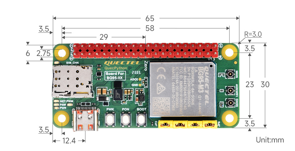

  • Dimensions: About 65 x 30mm (Raspberry Pi Zero form factor)
