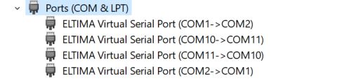

Virtual COM Port Driver is not a free software to use, but it offers 14 day trial for Pro version (didn’t try out the standard). Although both licenses state that you can create an unlimited number of virtual ports, but actually you can create a max of 127 virtual ports pairs (at least on my computer). This conclusion comes after giving the software a try. The ports created shown instantly on the computer.
Virtual Ports in device manager
