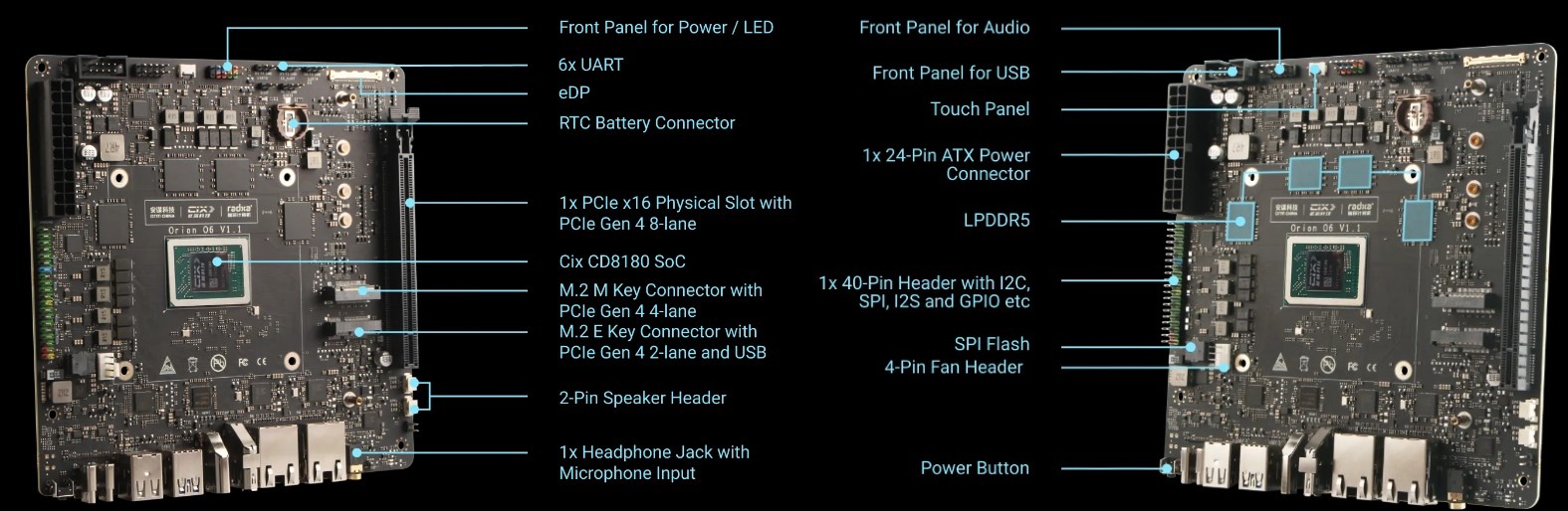

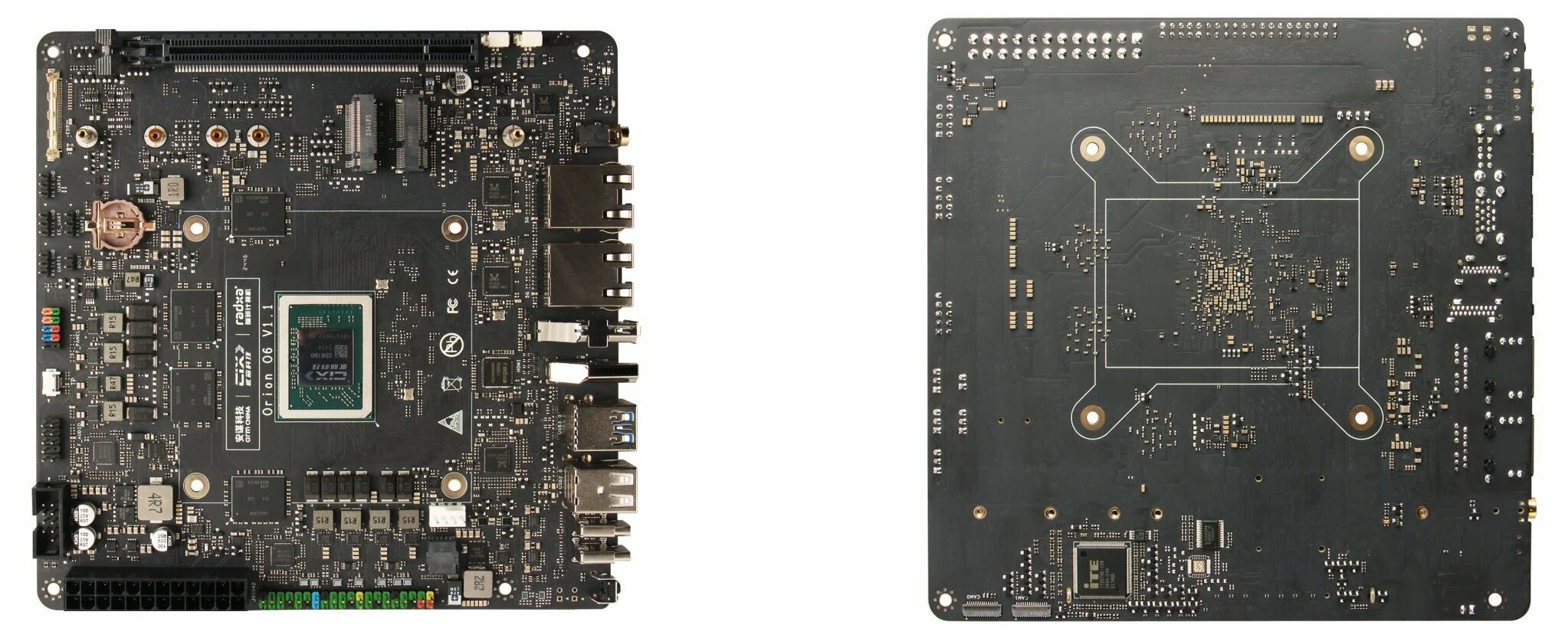

Radxa Orion O6 front and back

  • SoC: Cix CD8180
    • 12-core processor (ARM v9.2 architecture, 12MB shared L3 cache)
    • Core configuration:
      • 4x ARM Cortex-A720 cores @ 2.8 GHz
      • 4x ARM Cortex-A720 cores @ 2.4 GHz
      • 4x ARM Cortex-A520 cores @ 1.8 GHz
  • GPU:
    • 5th Gen ARM Immortalis G720 MC10 with hardware ray tracing
    • Graphics APIs: Vulkan 1.3, OpenGL ES 3.2, OpenCL 3.0
  • NPU:
    • 28.8 TOPS computing power
    • Supports INT4/INT8/INT16, FP16/BF16, TF32 precision
  • System Memory: 8GB, 16GB, 32GB, or 64GB LPDDR5 (128-bit, 5500 MT/s)
  • Multimedia:
    • Video Decoder: Up to 8Kp60 AV1, H.265, H.264, VP9, VP8, H.263, MPEG4, MPEG2
    • Video Encoder: Up to 8Kp30 H.265, H.264, VP9, VP8
    • Video Output:
      • HDMI 2.0 port (up to 4Kp60)
      • DisplayPort 1.4 (up to 4Kp120 MST)
      • USB-C with DisplayPort Alt Mode (up to 4Kp60 or 4Kp120)
      • eDP connector with touchscreen support (up to 4Kp60)
      • Quad-display support
  • Camera:
    • Dual MIPI Camera Ports
      • 2x configurable 4-lane or 2-lane MIPI CSI interfaces
      • Suitable for AI vision applications
  • Audio:
    • 3.5mm combo audio jack with microphone input
    • HD Audio front panel connector
  • Networking:

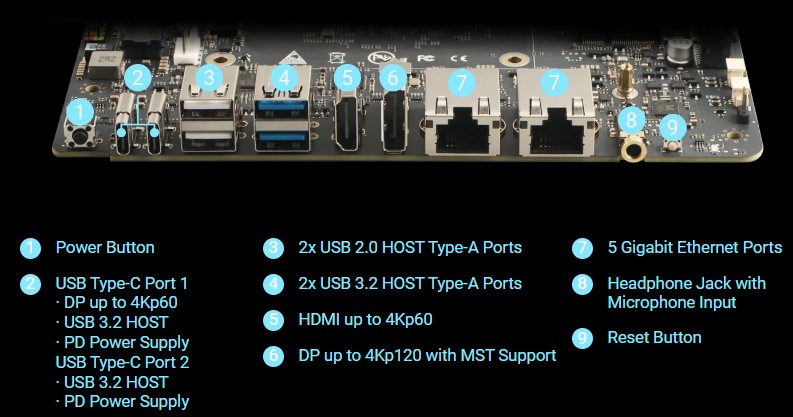

    • 2x Multi-gigabit 5Gbps Ethernet ports (10/100/1000/2500/5000 Mbps)
    • Wi-Fi 7 + Bluetooth module via M.2 Key-E socket
  • USB:
    • 1x USB 3.2 Gen 2 (10Gbps) Type-C with Power Delivery
    • 1x USB 3.2 Gen 2 (10Gbps) Type-C with DP Alt Mode and Power Delivery
    • 2x USB 3.2 Gen 2 (10Gbps) Type-A
    • 2x USB 2.0 Type-A
    • USB header for 2x USB 2.0
  • Expansion:
    • M.2 Key-M (PCIe Gen4 x4) for NVMe SSDs
    • M.2 Key-E (PCIe Gen4 x2) for Wi-Fi 6E and Bluetooth modules
    • PCIe x16 slot (PCIe Gen4 x8) for graphics cards and other PCIe devices
    • 40-pin GPIO header with 3x UART, 2x I2C, 2x I2S, 2x PWM, 1x SPI, 10x GPIO
    • 6x UART via headers
    • Serial Console header
  • Miscellaneous:
    • 4-pin CPU fan header with smart PWM control and speed monitoring
    • 75 x 75mm heatsink mounting holes
    • Power and reset buttons, status LED indicators
    • Real-Time Clock with backup battery holder (CR1220)
  • Power Supply:
    • 24-pin ATX power connector
    • 20V USB-C port (minimum 65W)
  • Dimensions: 170 x 170 mm (Mini-ITX form factor)
