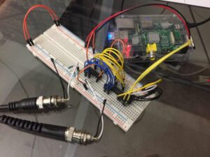

Raspberry Pi RF frequency counter
A Raspberry PI RF frequency counter project from Scott Harden, that is available on GitHub: Raspberry PI RF Frequency Counter with Python Interface. The RF signal clocks a 32-bit counter (SN74LV8154) connected to a 16-bit IO expander (MCP23017) accessable to the Raspberry Pi (via I²C) to prov... Read More
