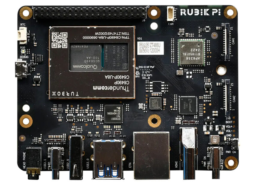

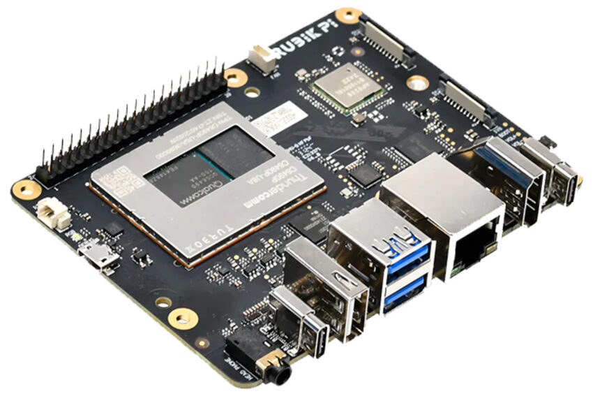

Thundercomm has recently launched the RUBIK Pi, a compact, versatile SBC powered by Qualcomm QCS6490, designed for developers needing advanced AI and multimedia capabilities. Supported by Qualcomm’s AI platform, Android, Linux, and Lu operating systems are supported, with 12.5 TOPS AI performance, making it suitable for applications in AI, IoT, and multimedia development. The compatibility of Raspberry Pi peripherals helps developers reduce costs and complexity. Key features include HDMI (4K@30), DisplayPort over USB-C (4K@60), multiple USB ports, MIPI-CSI camera support, Ethernet, and wireless connectivity (Wi-Fi 5, Bluetooth 5.2). With 8 GB RAM and 128 GB storage, a 40-pin GPIO header and M.2 SSD support are also integrated into the board, making it ideal for developers exploring AI-driven applications or IoT projects that require high data processing.  The appeal of building and testing a wide range of embedded solutions is further enhanced by the compact design and affordability.

RUBIK Pi AI Power SBC Specifications:
  • Platform(SOC): Qualcomm QCS6490
    • CPU: Qualcomm Kryo 670, 4x Arm Cortex-A55 Processor, 4x Arm Cortex-A78 Processor 64-bit up to 2.7 GHz
    • GPU: Qualcomm Adreno 643L up to 812 MHz supports OpenGL ES 3.2
    • DSP: Qualcomm Hexagon
  • AI Performance: 12.5 TOPS (Supports Qualcomm AI Hub)
  • Memory: 8GB LPDDR4x
  • Storage:
    • M.2 M-key slot for solid-state storage
    • 128GB uMCP storage
  • Display Outputs:
    • 1x HDMI 1.4 (4K @ 30 FPS)
    • 1x DisplayPort over USB Type-C (4K @ 60 FPS)
  • Camera Interface: 2x MIPI-CSI D-PHY (4 lanes)
  • Audio:
    • 1x 3.5mm headphone jack
    • Audio over HDMI
  • USB Ports:
    • 1x USB Type-C (USB 3.1 Gen 1)
    • 2x USB 3.0 Type-A
    • 1x USB 2.0 Type-A (host/device)
  • Networking:
    • 1x 1000M Ethernet port
    • Wi-Fi 5 (802.11 ac/a/b/g/n)
    • Bluetooth 5.2
  • Expansion:
    • 28x GPIO on 40-pin header (including I2S, PWM, I2C, SPI, UART)
    • 1x M.2 M Key connector for SSD
  • Debug: UART (over Micro USB)
  • Additional Features:
    • Power button
    • RGB LED
    • RTC battery connector
    • PWM fan connector
  • Power Supply: 12V/3A via USB Type-C PD
  • Dimensions: 100mm x 75mm

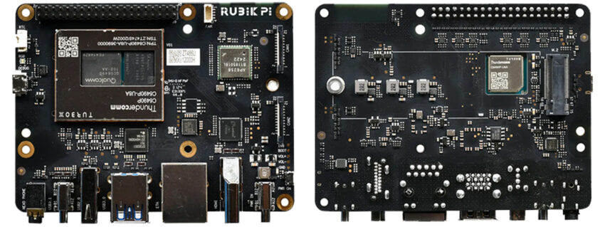

Rubik Pi AI SBC Views
Rubik Pi’s top and bottom views
Raspberry Pi accessories are supported by this SBC, making it easy for familiar peripherals to be integrated by developers without extra cost or hassle. Existing Raspberry Pi components can be leveraged by users due to this compatibility, making the Rubik Pi a flexible choice for diverse projects. According to the company, it is scalable, supporting Thundercomm’s C6490P, C8550 and C5430P SoM modules. With Qualcomm AI Hub, developers can utilize pre-optimized AI models or customize them for enhanced SoC performance.
The RUBIK Pi includes extra features like a real-time clock, an RGB LED that users can configure, and a PWM fan header. As of now, this SBC is not yet available for purchase, pre-orders are expected to open in early November. For further details, kindly visit the product page or press release.
