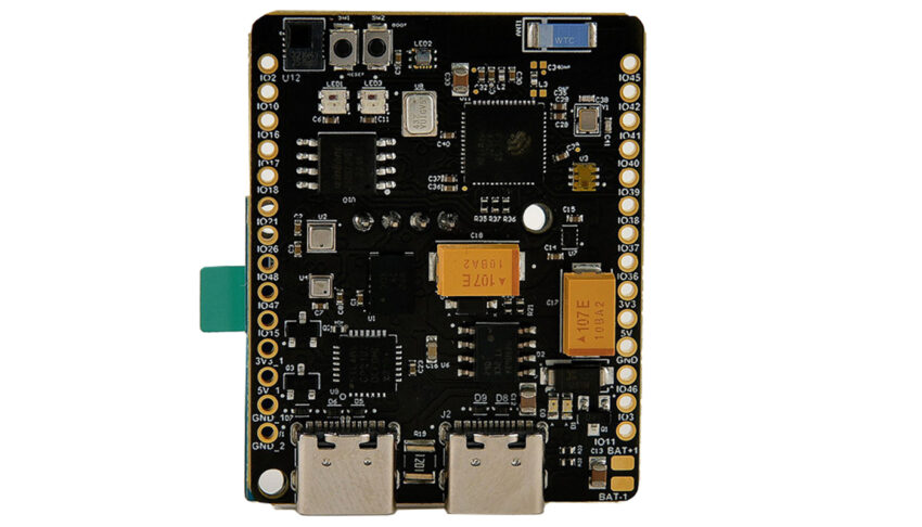

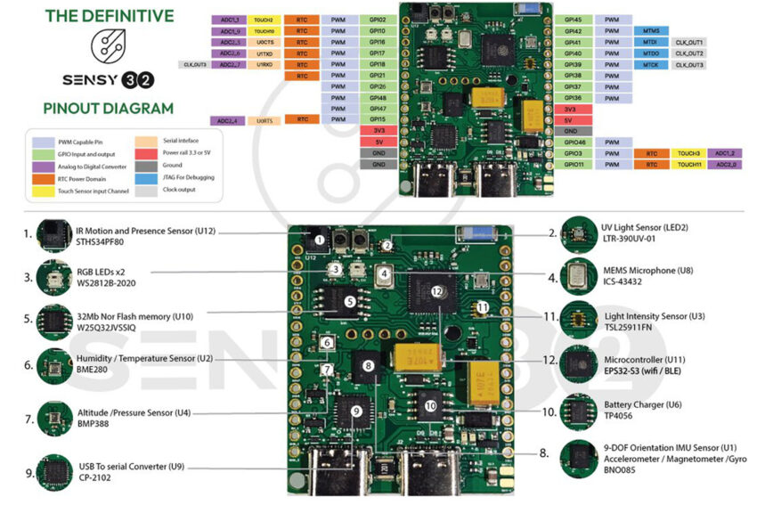

The Sensy32 All-in-One Sensor IoT Board is a flexible and advanced development platform designed for sensor enthusiasts, developers, and IoT creators. It is powered by the ESP32-S3 microcontroller, it integrates a wide range of sensors, including UV light, IR motion, humidity, temperature, altitude, pressure, 9-DOF IMU, light intensity, and a MEMS microphone.
Sensy32 IoT Board
Sensy32 has an LCD screen for real-time monitoring, Wi-Fi and Bluetooth connectivity, dual USB Type-C ports, RGB LEDs, and a battery charger, making it ideal for flawless sensor integration and data visualization. Supported by a user-friendly cloud platform, it enables the creation of custom dashboards for real-time monitoring and data storage for up to 30 days, with optional upgrades for extended storage. The Sensy32 board is ideal for a wide range of applications, including IoT projects, environmental tracking, smart home automation, and data analysis.

Sensy32 All-in-One IoT Board Specifications:
  • Microcontroller: ESP32-S3 Dual core XTensa LX7 @240MHz
  • Memory: 512KB RAM
  • Storage: 32Mb NOR Flash
  • Sensors:
    • UV Light Sensor
    • IR Motion and Human Presence Sensor
    • Humidity and Temperature Sensor
    • Altitude and Pressure Sensor
    • 9-DOF Orientation IMU (Accelerometer, Magnetometer, Gyroscope)
    • Light Intensity Sensor
    • MEMS Microphone
  • Display: Built-in LCD for real-time data visualization
  • Connectivity:
    • Wi-Fi 802.11b/g/n @2.4GHz
    • Bluetooth LE 5.0
  • USB:
    • 2x USB Type-C (charging, programming, and data communication)
    • USB to Serial converter
  • Misc:
    • RGB LEDs
    • Real-time monitoring and control
    • Supports up to 10 boards per account on the cloud platform
    • Extendable cloud storage for long-term data analysis
  • Power:
    • 5V via USB
    • Integrated battery charger for portable use
  • Dimensions: 43 x 34 mm
Additionally, it provides ready-to-use Python and C++ code samples for easy sensor data handling and is backed by detailed documentation and video guides.
The Sensy32 board is not open-source but comes with code samples provided in its Arduino library on GitHub. Priced at approximately $70 on Tindie, it offers a range of features but may not be the most cost-effective option compared to other alternatives. Additional details about the board can be found on the Sensy32 official website.
