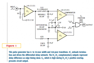

Simple nanosecond-width pulse generator provides high performance
by Jim Williams @ edn.com If you need to produce extremely fast pulses in response to an input and trigger, such as for sampling applications, the predictably programmable short-time-interval generator has broad uses. The circuit of Figure 1, built around a quad high-speed comparator and a high... Read More
