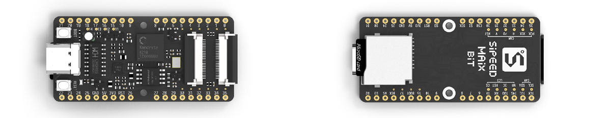

Sipeed MAix BiT development board
As many DIYer want build their own work with breadboard, Sipeed newly provide breadboard-friendly board for you, it called MAix BiT
  • It is twice of M1 size, 1×2 inch size, breadboard-friendly, and also SMT-able,
  • It integrate USB2UART chip, auto download circuit, RGB LED, DVP Camera FPC connector(support small FPC camera and standard M12 camera), MCU LCD FPC connector(support our 2.4 inch QVGA LCD), TF card solt.
  • MAix BiT is able to adjust core voltage! you can adjust from 0.8V~1.2V, overclock to 800MHz!
