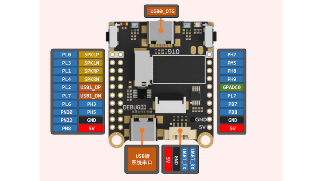

R329 Development Board Pinout
With 256MB DDR3 RAM, the board provides high-capacity and high-bandwidth memory support for voice recognition deep learning algorithms. It is designed with a reserved SPI flash and a MicroSD card socket for storing the programs. This is not the first implementation on the R329 chip as we have already seen R329 Intelligent Voice Development Board.
