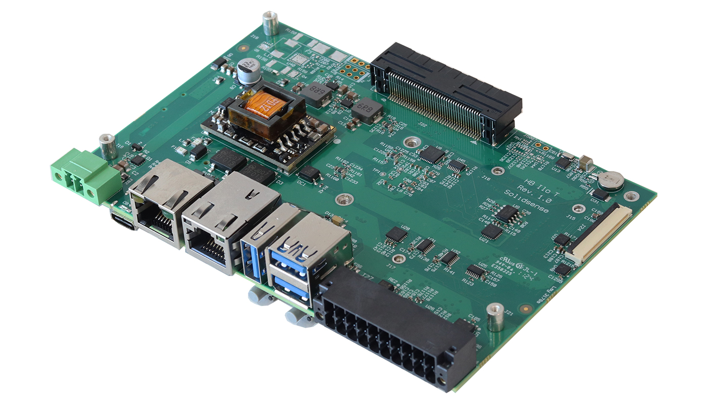

SolidRun has recently introduced the HummingBoard i.MX8M IIoT SBC and IIOT-200-8M Gateway, a compact and industrial-grade single-board computer designed for IIoT (Industrial Internet of Things) applications. It is powered by the NXP i.MX8M Plus Quad-core ARM Cortex-A53 processor, operating at up to 1.8 GHz, and supports industrial protocols like RS232, RS485, CAN-FD, and 1Gb Ethernet. With a robust aluminium enclosure and an extended temperature range of -40°C to 85°C, it is suitable for harsh environments and industrial installations.
HummingBoard IIoT SBC
Connectivity options include dual Ethernet, USB 3.0, WiFi/Bluetooth, and expandable M.2 slots for LTE, NVMe storage, and AI accelerators, ensuring scalability for diverse use cases. This board supports industrial displays for HMI applications and comes with comprehensive software support for Yocto and Debian BSP, featuring drivers for peripherals like TPM 2.0, RTC, and Wi-Fi/BLE.
Its compact size (120x80x30mm) allows for DIN rail mounting, which makes it ideal for industrial automation, edge computing, and IoT gateway applications requiring high performance, reliability, and long-term availability.

The HummingBoard i.MX8M IIoT SBC Specifications:
  • SoC: NXP i.MX8M Plus
    • CPU:
      • Quad-core ARM Cortex-A53, up to 1.8 GHz
      • with Arm M7 GPP, up to 800 MHz
    • GPU:
      • Vivante GC7000UL 3D
      • Vivante GC520L 2D
    • DSP: HiFi 4 (for voice and natural language processing)
    • VPU: 720p60 H.265/H.264 Video Encoder and Decoder
    • NPU: 2.3 TOPS for Optional AI Accelerator
  • Memory:
    • Up to 8GB LPDDR4
  • Storage:
    • Up to 128GB eMMC
    • MicroSD card slot
    • M.2 M-Key
    • EEPROM
  • Display Interfaces (on Evaluation Kit):
    • LVDS and MIPI-DSI for 7-inch touch displays
    • Not available on the IIoT gateway model
  • Camera Interfaces:
    • 2x MIPI-CSI (4 lanes)
  • Networking:
    • 2x Ethernet RJ45 (10/100/1000 Mbps)
    • WiFi 802.11 a/b/g/n/ac (2.4/5 GHz)
    • Bluetooth
  • Industrial Interfaces with I/O connector:
    • 2x RS232
    • 2x RS485
    • 2x CAN-FD
  • USB Ports:
    • 1x USB 3.0 OTG
    • 2x USB 3.0 Host
  • Expansion:
    • M.2 B-Key slot for LTE modems (eSIM and NanoSIM support)
    • M.2 M-Key slot for NVMe storage or AI accelerators
    • Additional add-on cards supported
    • GPIO
  • Security: TPM 2.0
  • Misc: RTC (Real-Time Clock)
  • Power Supply:
    • Input: 7V – 32V
    • PoE support (802.3at)
    • Reverse polarity protection
  • Enclosure:
    • Extruded aluminium
    • DIN rail mounting support
  • Dimensions:
    • 120 x 80 x 30 mm (Carrier Board)
    • 140 x 90mm (PCBA)
  • Temperature Range: -40°C to 85°C (industrial-grade)
