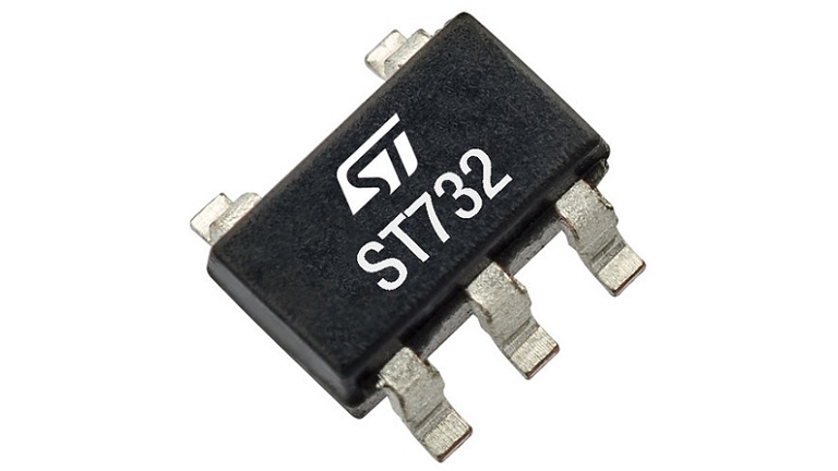

ST732 – 300mA, 28 V low-dropout voltage regulator, with 5 µA quiescent current
The ST732 is 300 mA LDO regulator, designed to be used in several medium voltage applications.
Ultra-low quiescent current of 5 µA makes it suitable for applications permanently connected to power supply/battery. This feature is also useful when electronic modules remain permanently turned on.
The ST732 embeds protection functions, such as current limit, short-circuit, and thermal shutdown. The extended input voltage range, very low drop voltage, and low quiescent current features make it suitable also for low power after-market automotive and consumer applications.
Key features
- Wide input voltage range: 2.5 V to 28 V
- Ultra-low quiescent current: typ. 5 µA at no-load, 10 µA max. across the full temperature range
- Output voltage accuracy: ± 2%
- Output current up to 300 mA
- Fixed output voltage versions, starting from 1.2 V with 100 mV step
- Stable with low ESR capacitors (0.47 µF min.)
- Thermal shutdown protection
- Current limit protection
- -40 °C to +125 °C operating temperature range
