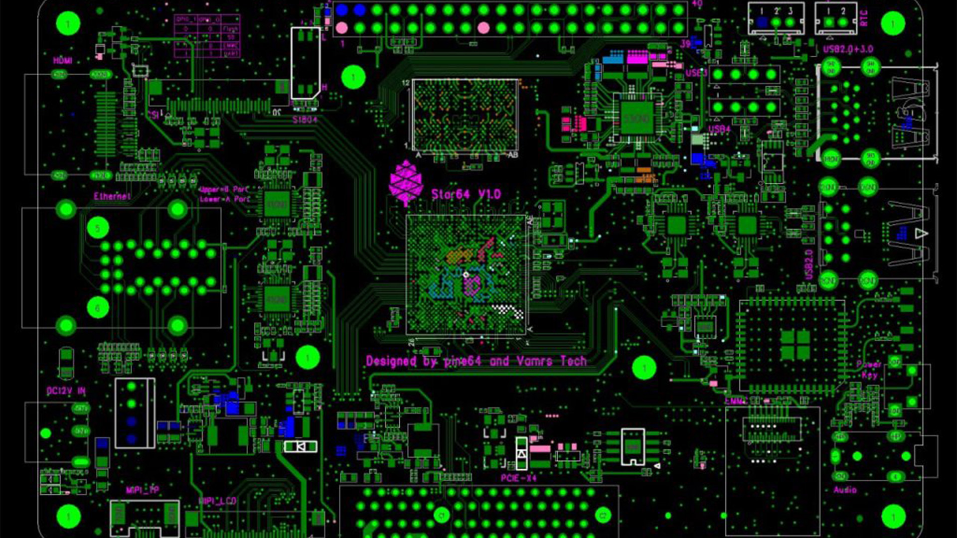

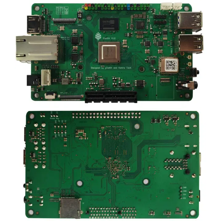

PINE64 has now released more details on its upcoming RISC-V single board computer named Star64, claiming that the SBC will be powered with the RISC-V-based StarFive next-generation JH7110 64-bit SoC and will follow the model “A” form factor just as the earlier Quartz64 model A board.
“The Star64 is a single board computer comparable to the Quartz64 Model-A — the notable difference being the RISC-V SoC at the heart of the SBC,” says Lukasz Erecinski from Pine64 explains.
The Star64 board will be powered by a StarFive JH7110 64-Bit RISC-V chip which has performance that can be compared to the Rockchip RK3566 quad-core ARM Cortex-A55 SoC. The StarFive JH7110 offers 4x SiFive FU740 processor cores running at 1.5GHz and Imagination’s BXE-4-32 graphics.
StarFive’s JH7110 64-Bit RISC-V chip has a performance comparable to the Rockchip RK3566 quad-core ARM Cortex-A55 SoC. It is the world’s first high-performance, low-power consumption, multimedia processing chip designed for RISC-V applications, offering 4x SiFive FU740 processor cores running at 1.5GHz, Imagination’s BXE-4-32 graphics, H.264/H.265 video codecs IP and ISP IP. So it is a big deal that the Star64 is going to be powered by the StarFive JH7110 processor.
The Star64 SBC will also be offered with an HDMI 2.0 video output connector, an RTL8852BU module with support for WiFi 6 & Bluetooth 5.2, CSI camera support, and a microSD card. It will also feature up to two native Gigabit Ethernet ports, but other models with just one GbE port will also be made available in the future for $5 less.
“The board will be available in two configurations, with 4 and 8GB of RAM, and we aim to match the Quartz64’s price point of the respective hardware versions,” Erecinski further explained. “Similarly to the Quartz64 Model-A, the Star64 will feature an open-ended PCIe port, USB 3.0, and GPIO (General Purpose Input/Output).”

Preliminary Specifications:
  • StarFive JH7110 quad-core 64-bit RISC-V processor running at up to 1.5 GHz with
    • Imagination BXE-4-32 GPU with support for OpenGL ES 3.2, OpenCL 1.2, Vulkan 1.2
    • 4K@30 H.265/H.264 video decoder
    • 1080@30 H.265 video encoder
  • 4 or 8 GB LPDDR4
  • 1x eMMC flash module socket
  • 1x MicroSD card slot
  • QSPI flash
  • 2x GbE RJ45 ports
  • On board RTL8852BU WiFi 6, Bluetooth 5.2, 2x u.FL antenna connectors
  • 1x HDMI 2.0 port
  • 4-lane MIPI DSI connector
  • 2-lane MIPI CSI camera connector up to 4K@30
  • 3.5mm audio jack
  • 40-pin color-coded GPIO header
  • PCIe x4 slot
  • 1x USB 3.0 port
  • 2x USB 2.0 ports
  • 3x USB 2.0 Type-A ports
  • 3-pin UART/debug header
  • DIP switch for boot configuration
  • Power button
  • Fan header
  • Power: 12V DC via power barrel jack or 4-pin header
  • Dimensions: 133 mm x 80 mm
The 4GB RAM version of the board is expected to sell for $60 while that of 8GB RAM should go for $80.
The company has not yet announced a launch date yet but it claims that the board is in the final layout stage and should be available in a few weeks to interested developers only.
You can get more details on the announcement page, or join their discord group for updates.
