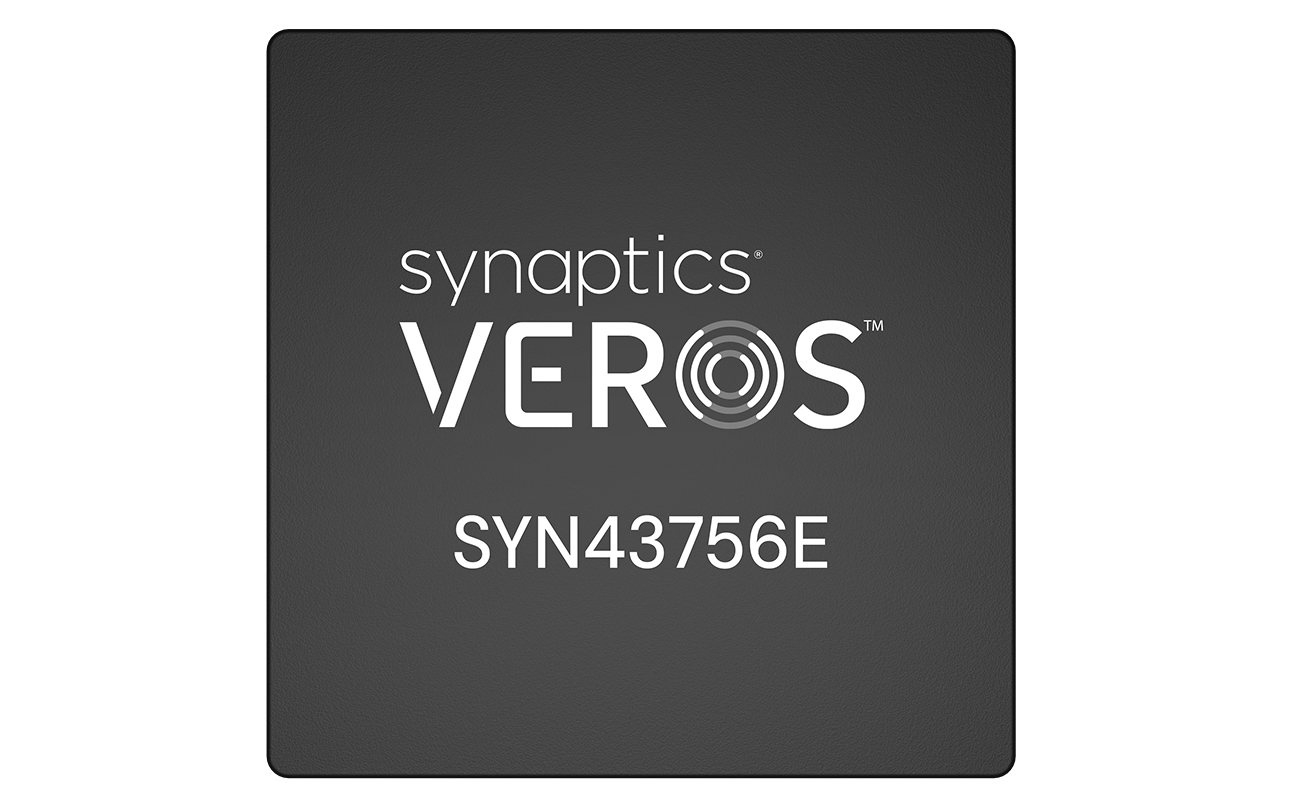

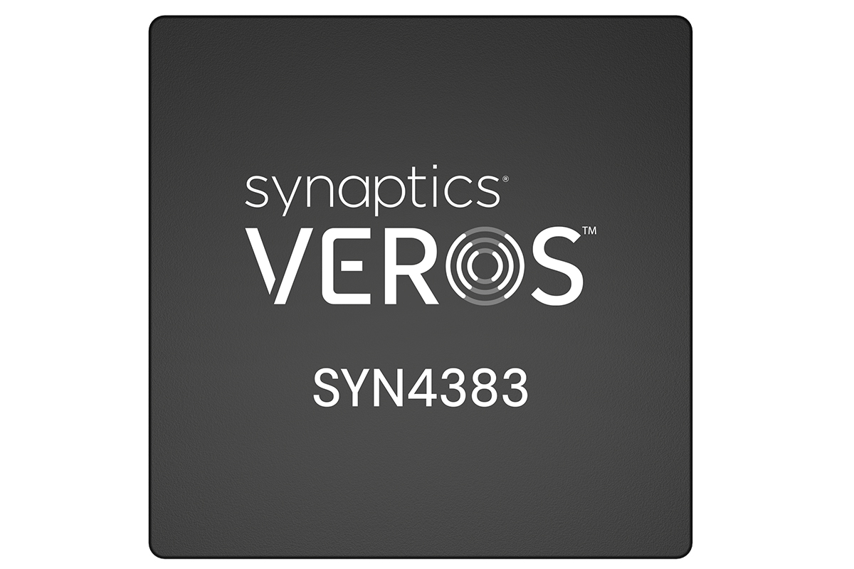

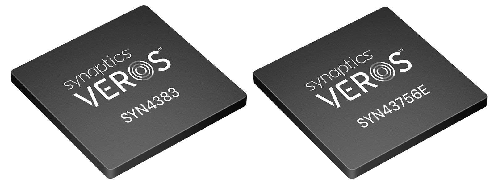

Synaptics has finally revealed the SYN4383 and the SYN43756(E) high-performance, compact tri-band SoCs, that integrate Wi-Fi, Bluetooth, and IEEE 802.15.4 radios to optimize wireless connectivity for IoT devices. Both chips support Wi-Fi 6/6E with 2×2 MIMO antenna configurations, delivering up to 1200 Mbps throughput and enabling simultaneous 2.4 GHz and 5/6 GHz band operation for robust, real-time streaming and connectivity.
They are arranged for smart homes, automotive in-cabin entertainment, security, personal tracking, and industrial IoT applications. These SoCs feature advanced Bluetooth (5.3 in SYN43756(E) and 5.4 in SYN4383) with LE Audio for multiple audio streams and Bluetooth Channel Sounding for precise positioning, making them ideal for audio-centric and location-sensitive applications. Additionally, SYN4383 supports IEEE 802.15.4 for Zigbee and Thread protocols and is Matter-compliant for secure, interoperable connectivity in diverse wireless environments. Both chips include Smart Co-Ex technology, ensuring the effective coexistence of Wi-Fi and Bluetooth in the 2.4 GHz band, while reducing space, cost, power, and system complexity.

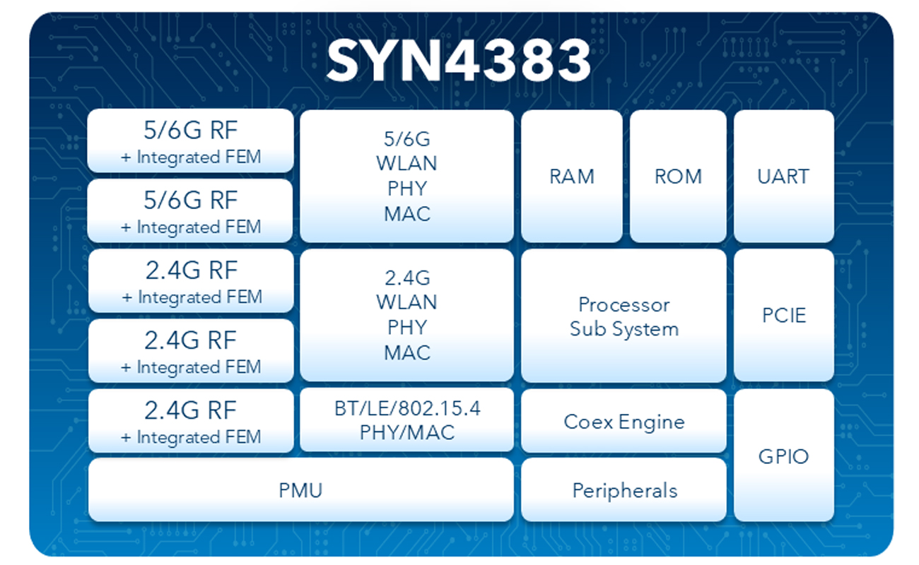

SYN4383 SoCs for IoT devices Block Diagram
SYN4383 Block Diagram
Synaptics Veros SYN4383 Wi-Fi 6E, Bluetooth 5.4, 802.15.4 SoCs features and highlights:
  • Tri-Band 2×2 MIMO Wi-Fi 6E (802.11ax):
    • Up to 1200 Mbps throughput.
    • Real Simultaneous Dual-Band (RSDB) operation with 2.4 GHz and either 5 GHz or 6 GHz.
    • Backward compatibility with legacy Wi-Fi standards, including 802.11a/b/g/n/ac.
  • Bluetooth 5.4:
    • Compatible with Bluetooth 6.0.
    • Includes LE Audio for advanced audio streaming.
    • Supports Channel Sounding for precise positioning.
  • 802.15.4 Radio:
    • Provides support for Thread and Zigbee protocols.
  • complemented by an integrated T/R switch for optimized performance

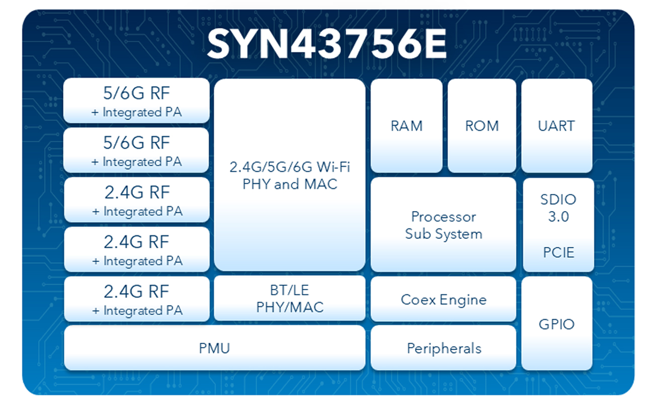

The SYN43756(E) shares similarities with the SYN4383 but does not include an 802.15.4 radio or RSDB support. While it targets the same applications, it is not ideal for position tracking due to the absence of Channel Sounding. Designed as a cost-effective option, it suits applications that do not require an 802.15.4 radio, Wi-Fi RSDB, or the most advanced Bluetooth features.
SYN43756(E) SoCs for IoT devices Block Diagram
SYN43756(E) Block Diagram
Synaptics SYN43756(E) tri-band Wi-Fi and Bluetooth combo SoC features and highlights:
    • Supports up to 1200 Mbps throughput.
  • Bluetooth 5.3:
    • Includes LE Audio for enhanced audio streaming.
    • Does not support Channel Sounding.
  • Advanced Wi-Fi/Bluetooth Coexistence:
    • Ensures seamless operation in shared frequency bands.
