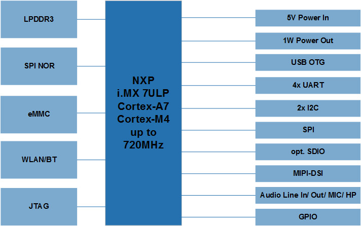

PicoCore MX7ULP Block Diagram
The PicoCore MX7ULP ships with up to 1GB LPDDR3 RAM, 64MB SPI NOR flash, up to 32GB eMMC, and an optional SD slot. There’s also an option for a wireless module with 802.11b/g/n and Bluetooth 4.1 LE. For display, you get a MIPI-DSI interface that is accompanied with I2C-based resistive and capacitive touch support.
