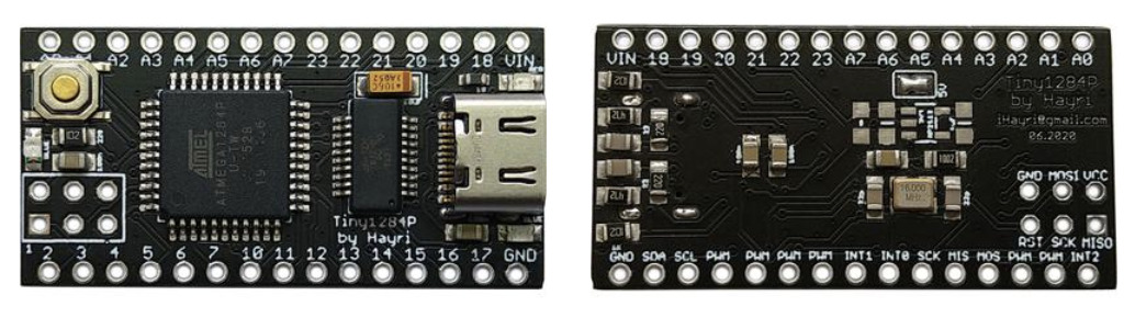

Hayri Uygur is set to launch his new product: a tiny, breadboard-friendly and open-source Arduino-compatible development board, aptly-named Tiny1284P.
The Tiny1284P development board is built around the high-performance low cost ATmega1284P-AU 8-bit microcontroller that combines 16KB of static RAM, 4KB EEPROM, 128KB in-system self-programmable flash memory with read-while-write capabilities, and a 20 MIPS throughput at up to 20 MHz.
The Tiny1284P development board is smaller but yet more powerful than comparative ATmega328 development boards. The Tiny1284P, according to the Bulgarian electronics specialist, is
“a huge upgrade from other similarly-sized boards that use the ATmega328, with 4 times more flash, 8 times more RAM and 4 times more EEPROM.”
This means the Tiny1284P can easily be used for projects that the ATmega328 is probably too small for, even within the same form factor. The presence of the USB Type-C in the Tiny1284P also implies better connectivity for those working on Atmega328-based boards.

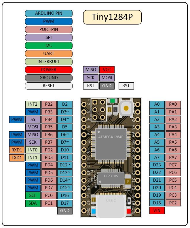

Key features and specifications of the Tiny1284P development board include:
  • ATmega1284P-AU 8-bit AVR microcontroller running at 16 Mhz in a default 5V mode or 8 Mhz at 3V.
  • 128KB of flash memory
  • 4KB EEPROM
  • 16KB of Static RAM (SRAM)
  • USB Type-C connector for programming as well as power delivery
  • USB 2.0 full UART transceiver
  • JTAG interface (IEEE std 1149.1 compliant)
  • 6-pin ISP header
  • Breadboard-friendly GPIO covering 2x UART, 3x SPI, 6x PWM and 1x I²C bus capabilities
  • Reset switch, onboard LED, RX/TX LEDs, and
  • External 5V power supply input.
