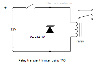

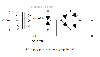

Transient voltage suppressor diodes or TVSs are semiconductor devices used to clamp transient voltages and current, such as electrostatic discharge, inductive switching kickback, induced lighting surges etc. TVS are used for diversion or clamping in low voltage and low energy, modest frequency systems and are way more reliable than a diodes. They come in unipolar and bipolar versions. Unipolar TVS breaks down when the specified breakdown voltage is exceeded and pass current in one direction, in the opposite direction of the arrow. In contrast bipolar TVS can handle current in both directions. TVS are invisible to the circuit they are placed to until a transient appears. When a transient appears, TVS clamps instantly to limit the spike to a safe voltage level. The breakdown voltage of TVS should be selected to have a breakdown voltage greater than the working voltage of the circuit protecting. Some of the advantages of TVS is that they are fast, easy to use and fail with short-circuit. Some of the disadvantages is that their high capacitance limits the frequency they can be used, they can be used in low energy systems and are more expensive than Zener diodes and MOVs.

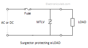

Multilayer Varistor or MLTV is a surface mount variation of MOV. Due to the surface mount contacts MLTVs have lower self-inductance and series resistance allowing for much quicker response times, typically less than 1 ns. The energy rating of MTLV are lower than other types of varistors but they can survive many thousands of strikes at full rated peak current. They are used on low voltage (3-70V) systems with modest frequencies. They are fast, compact and bidirectional, but more expensive than other MOVs and their high capacity limits their use on high frequency systems.

The surgector uses a silicon thyristor technology to provide bidirectional “crowbar” clamping action for transients. Surgectors remain in a reverse bias state as long as the voltage across is it is below breakdown voltage. If a transient voltage appears then the device breakdowns beginning the clamping action. If the transient voltage rises higher until the breakover voltage is reached a thyristor action is triggered and the surgector latches to ON state, thus short circuiting the transient voltage.
