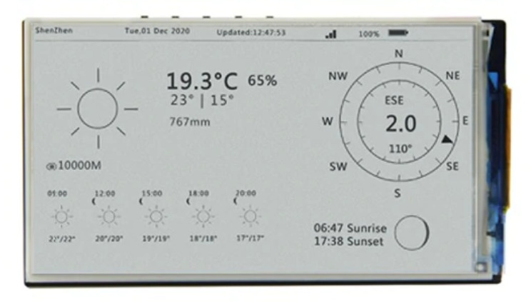

So, what is it about the TTGO T5? It is a development kit based on the ESP32 platform, with a 4.7” e-ink display (are you having a déjà vu feeling about the M5Paper?). Talking about the display, there are multiple options, ranging from 1.02” to 4.7”, with 16 gray levels and no support for the touch screen, although there is a 6-pin FPC connector for it. Just a reminder, the M5Paper takes the lead slightly here, with multi-touch support and extra robustness due to the enclosure. The M5Paper also comes with an enclosure, which you will not find here.

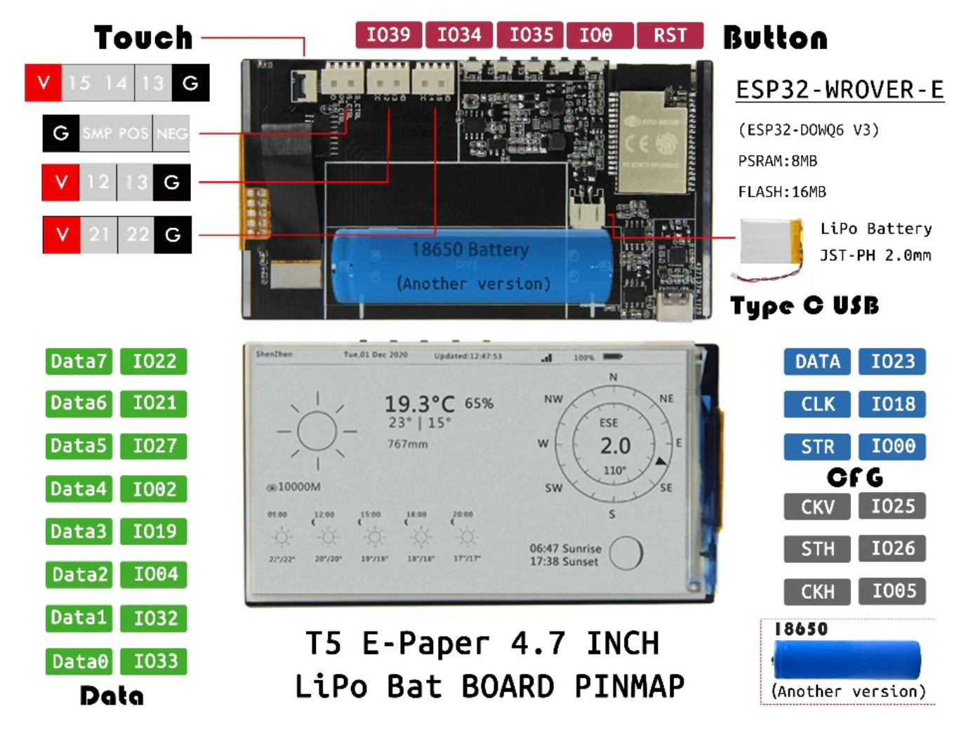

- ESP32 WROVER-E dual-core MCU, with Bluetooth, BLE and Wi-Fi support
- Memories: 16 MB Flash and 8 MB PSRAM
- 4.7” e-ink display with a resolution of 540 x 960, 16 gray levels and partial refresh support (and a 6-pin FPC touch screen connector, but no current touch screen support)
- 3x 4-pin molex connectors for GPIOs and 5 buttons (4x for custom function and 1x for reset)
- Sleep mode current of 170 uA
- Power supply options:
- USB Type-C (5 V / 1 A)
- Metal connector for 18650 mAh battery (optional) and 2-pin connector for LiPo battery, with battery charge and discharge protection circuitry
